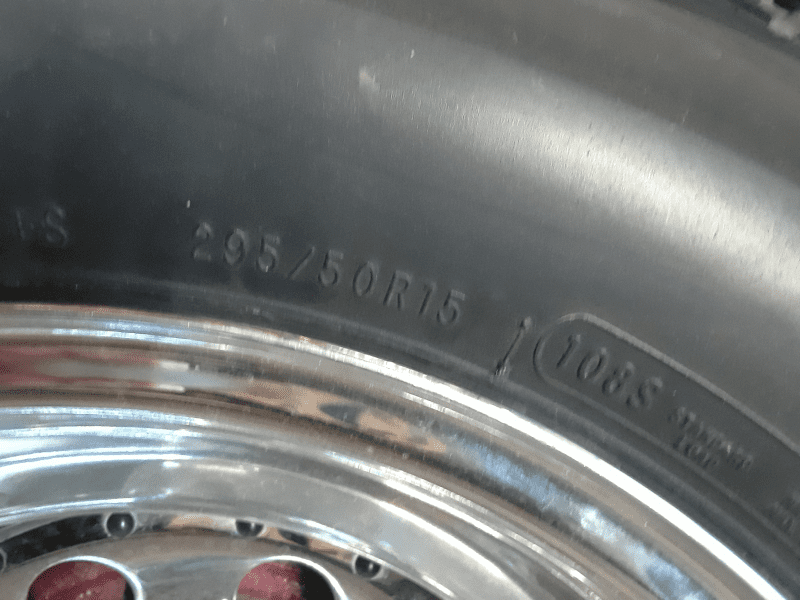

I have 295 50 15s which are way too short but that's all they had back then for fatties.

I had 295/50 R15 on the back of mine prior to restoration. It will be using a different size wheel & tire setup this time around.
