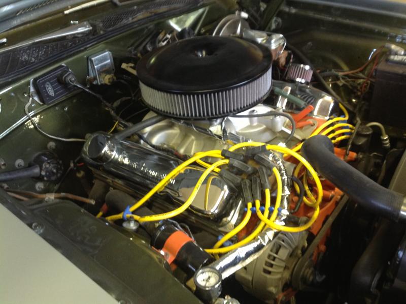

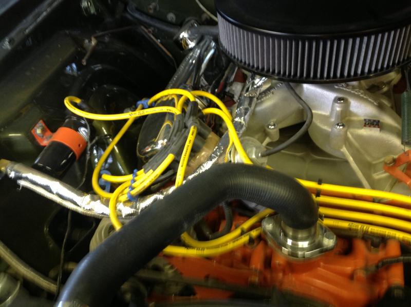

Try wrapping the fuel lines to the carb. I had. A similar problem with my 512 and a heat wrap plus always using non ethanol gas has seemed to fix my problem. I think that in my case there was so little clearance between the intake and the fuel line to the carb that the gas was cooking on the way in. image.jpgimage.jpg

Sorry, only pic I could find:
