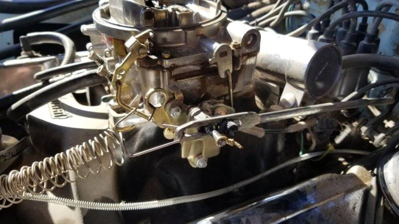

But there's more. The previous owner and I had replaced the spark plugs some days prior as they were horribly fouled. The engine had definitely been running rich for quite some time. Or perhaps poor spark had kept the fuel from burning properly. In any case, the new plugs are now fouled as well. The one I pulled was also still a little wet. Presumably from my unsuccessful efforts to start the engine. Is the carb or jetting too big maybe? I've read that a 600cfm suits a lightly built 318 just fine. And Eddies are usually fairly plug and play. The way the throttle linkage is set up doesn't quite look right to me, though. As I understand it, certain linkage kits and some creativity may be needed for proper mounting of a 4 barrel Eddie. Or maybe it is set up alright. I'm sure you'll know better.

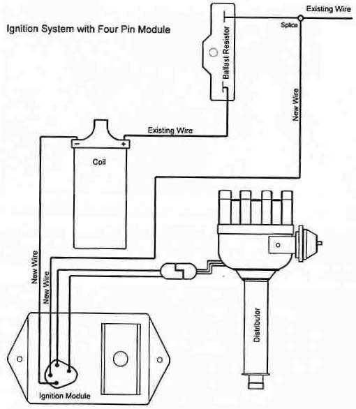

a few Ideas to check
bad Ballast resister,
the dark blue wire should have voltage on both sides of the ballast resister
Bad grounds,
need good grounds, especially to the engine to body
& body to battery/chassis
paint or rust/corrosion under/or bad ground on the CEI box
on the fire wall
MoPars are notorious for
firewall/bulkhead connectors are rusty/oxidized or corroded,
could need some cleaning, be careful unplugging them, they can be really brittle
or Fusible link is blown/bad
good luck hope some of that helps
