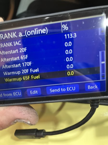

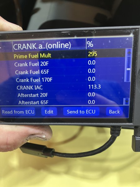

Would any of you smarter than me People that has tuned a Fitech 6 pack be willing to share their experience with me, mine is running very rich and when I accelerate it knocks and the works ok, I’ve played with the timing and no real difference. Any help is greatly appreciated here’s some pics of the settings that came from the factory

Is it rich just when starting and warming up? That is the displays shown.

I want to thank everyone for their knowledge and advice, I am making progress! I set the AFR 10 14.5 and that made a huge difference, checked all the connections and grounds, it has a strong 12v. I’m starting to play with the timi and will let everyone know how it goes!
