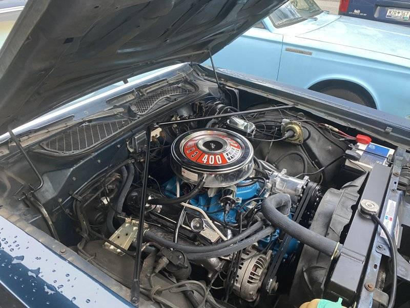

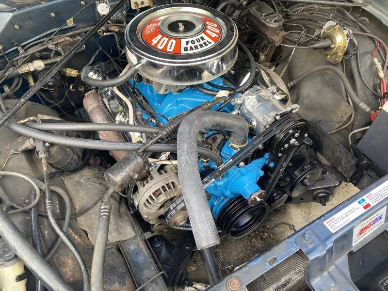

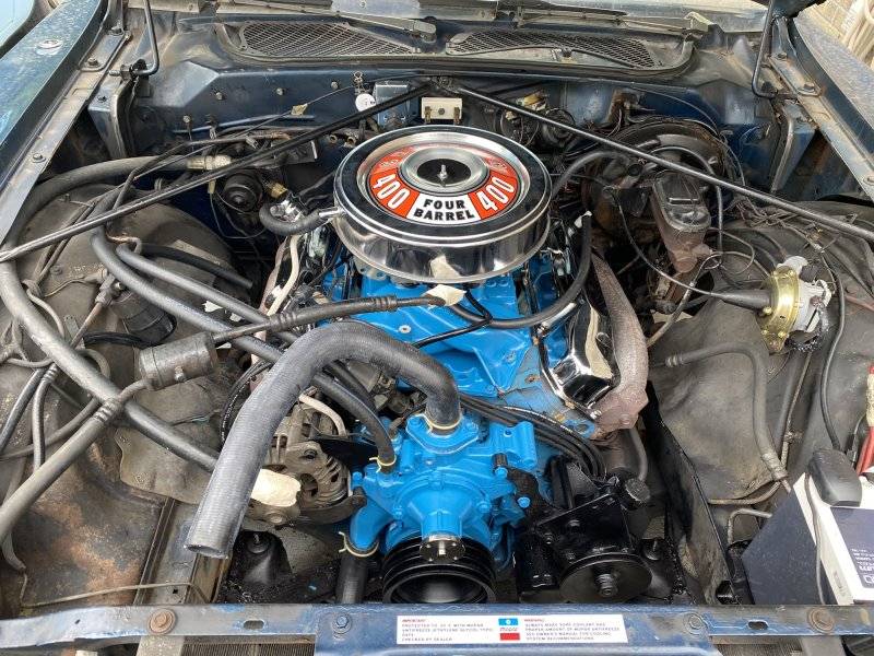

View attachment 1358194View attachment 1358195View attachment 1358196
Thanks, I think this is what I will do. Can you share where you got your upgrade parts?
