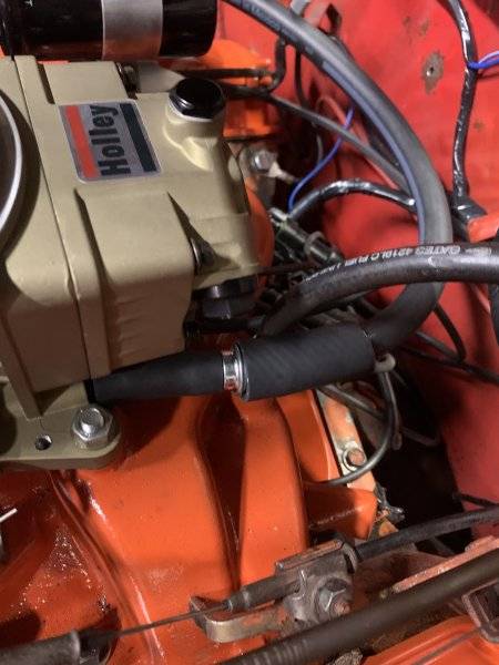

I used a 69 PCV and removed the tube, and drilled out the valve inside, and then used superglue on the tube and put it back together. No more valve inside. Someone have the 69 type for sale on here, just need to modify it.
Thanks for the link. Question on how you modified this valve. My plan B was to use a straight piece of 1/2 inch pipe I have, fill it with JB Weld, and then drill a .1 diameter hole through the middle. Its my understanding that a small diameter hole is whats needed. On the 69 valve you modified did you just leave it a hollow tube? Are you running sniper?
Yes, I am running a Sniper, I used a wrench to hold the PCV and was able to remove the tube. I used a drill to open the hole to remove the valve, once I removed it, I reattached the elbow. I am using it to keep the OE look, and at the Throttle body I have a PCV2377 fixed orifice valve, I had to use 2 different size hoses and glue them together. You can't tell I have EFI.

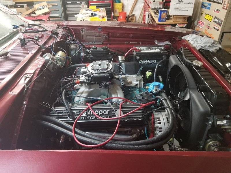

I like how you did that. I have a PCV 2377 also and was looking for a way to use that with the correct grommet for my valve cover. No joy. I'm not looking for OE look but I want everything to function properly. Nice looking install. Not like my rats nest!

Any photos?
