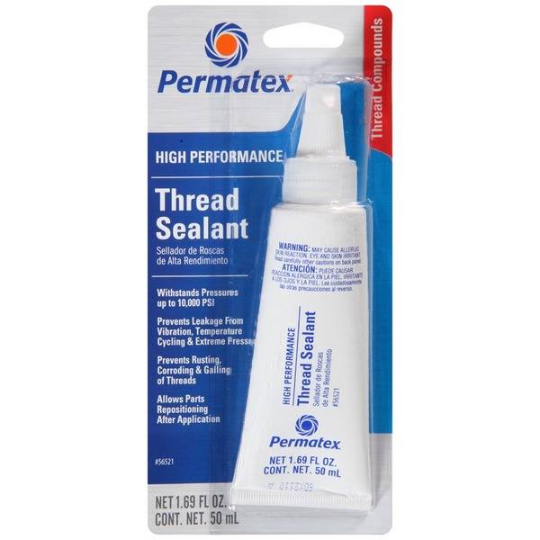

TTI header flanges are 3/8" thick. So, you can get away with taking out one at a time. Use a Teflon thread sealant like this:
%2F441py33rout1ptjxn2lupv31-wpengine.netdna-ssl.com%2Fwp-content%2Fuploads%2F2016%2F02%2F56521CF.jpg
Thank you guys. Will tackle this in the am. Appreciate the advice.

I'm with Doug. I use ARP thread sealer, which is a paste. No worries about pulling just the end bolt. 3/8" flanges on the TTIs. No need to use a full cooling system sealer, as we know where the leaks will be on Mopar heads...lol.
