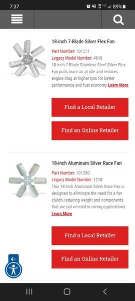

Here are Flex a lites factory style 18" fans.
Here are Flex a lites factory style 18" fans.View attachment 1167579
VERY NICE PICTURES......BUT, "pulls more air at idle" means nothing.....how much air is "more air"? Quantify with a CFM number and at what operating RPM. Regarding the race fan application, what components are "not needed for a race application"? AND WHAT IS THE MAXIMUM RPM that is allowed b4 self destruction.

I appreciate that you want to show your expertise. There is "No" cfm per rpm for the factory fans either. The OP asked for some info on Flex fans. I appreciate that you are bored.

Bored??? Absolutely not. I believe the OP asked if flex fans were any good.....IMO....short answer....NO. With regard to the use of fans in general, the presented information is to help make an intelligent decision....take it or leave it....its up to you. But without accurate information its impossible, or nearly so, to make a worthwhile decision....about fans or just about anything else.
