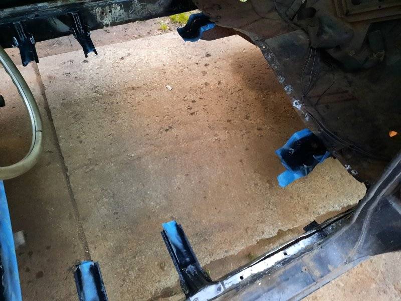

Pull carpet back and cover it up to protect it.
Cut hole to clear all thin rusted steel. Do not let grinding sparks fly freely to damage your chrome, plastic and glass.
Make a patch and trim it until it is .023 smaller than hole. Welding wire gap around all edges.
Position and hold in place with magnets.
Tack in place.
Weld solid.
Cover with seam sealer.
Wire wheel clean.
Prime and paint with any color available.
Lay carpet back over top.
It is a floor!
If you are not concerned with replacing the whole panel, a patch is way better to do. Original steel is in place already.
