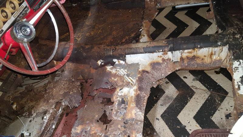

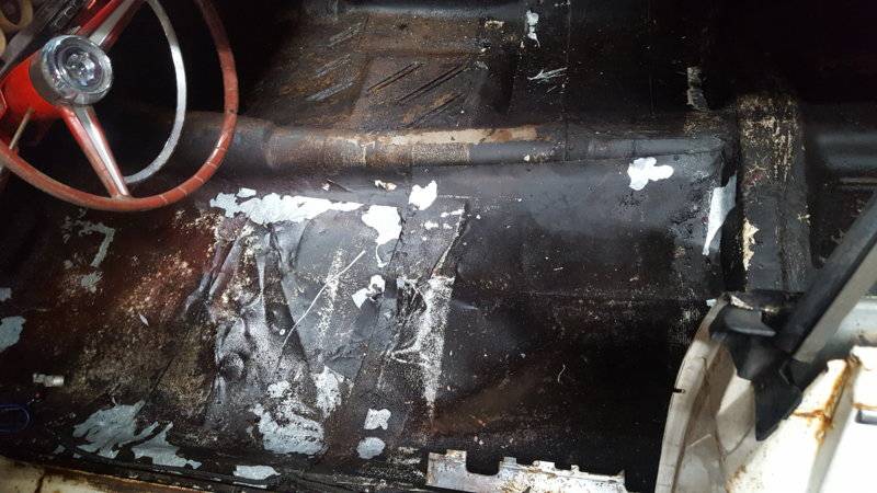

Previous owner cut out sections and replaced with galvanized signs and sprayed black something on top.
I have an AMD floor, and will soon have the two rear pans. There are two small areas under the rear seat where fiberglass was placed on top. Not concerned about those at the moment, but I will investigate.

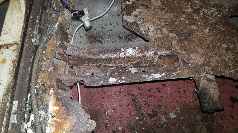

The torsion bar crossmember is rusted on the driver's side at the rocker. I have a parts car with a good crossmember.

Take a picture of the cross member damage so we can help you decide on that. First thought is that unless the rust is really localized in one or two spots just replace the whole thing.

Then I'll clean up the rust and get better pics of problem areas.

This was the floor pan riveted in by the previous owner.

I'm going to be doing a torsion bar crossmember for my buddy in the future.
My strategy would be to drill the spot welds out in the floor (just hog them out with a drill) and use the original floor as a reference to line up the new xmember.
I would have to cut out the outer floors over the xmember to get to the 4 spot welds where the xmember attaches to the rockers.
Tough to install the torsion bar cross member with the floor in place.
