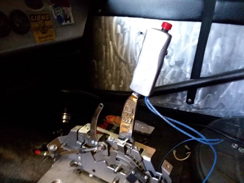

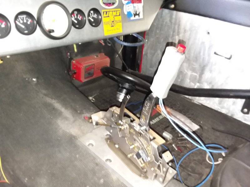

Well, I use, and love my B&M pro ratchets, but those cars have full manual valve bodies in them, and are raced. I have also used the Turbo Action Cheetah, an excellent piece.

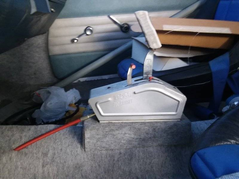

Pro ratchets, with home made pistol grips.

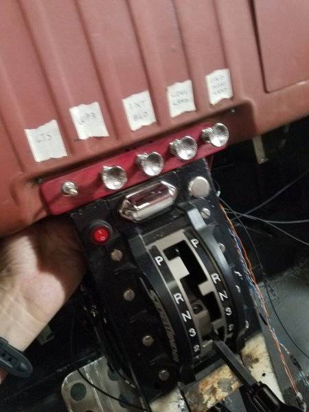

I use what 33 IMP suggests. Winters
Sidewinder. I plan on cutting off the
tabs on the shifter gate to enable
shifts 1 thru 3 as an OEM would
normally operate. The shifter is
rugged and well built. It's been a big
favorite of off-roaders for many years.
