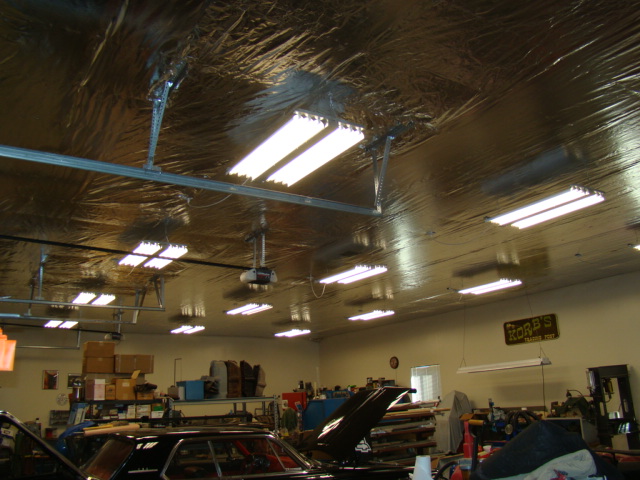

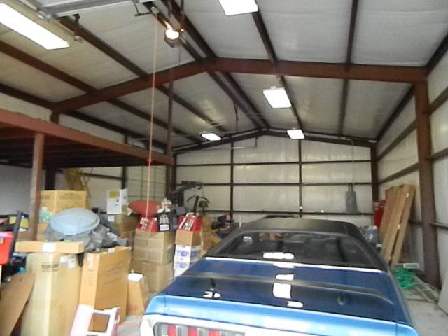

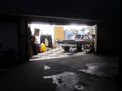

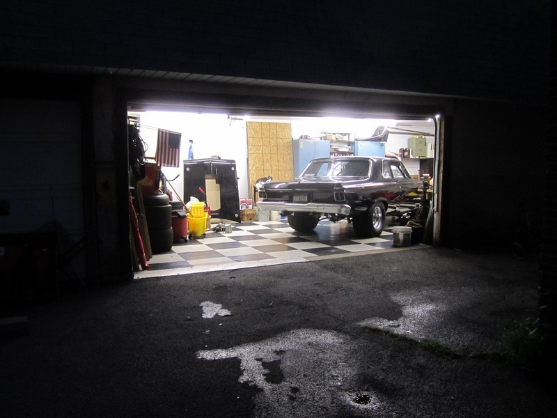

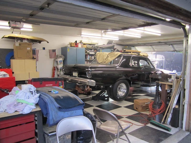

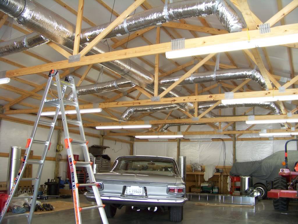

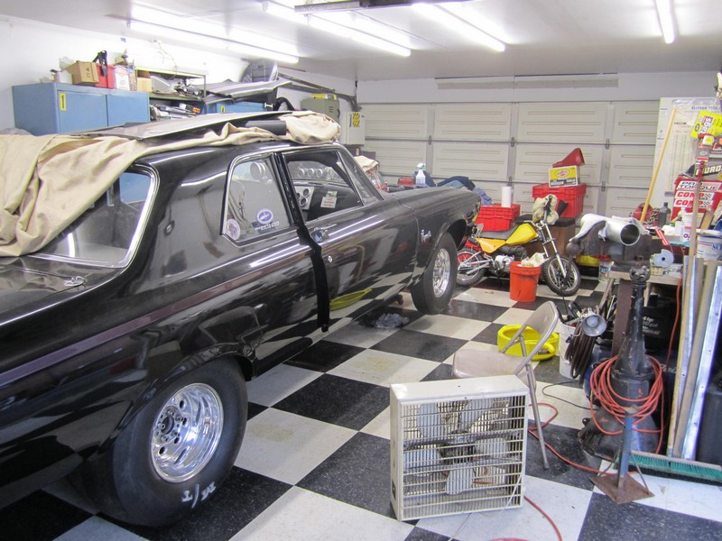

In my garage I installed 7 8 ft double t5 light fixtures.MAN IT"S BRIGHT in there!!!IMO.1 double 4 ft is better than an old Double 8 ft florecent!!

Thanks for the input guys. What type FIXTURES do you recommend? Love the shop pictures. Very cool!
