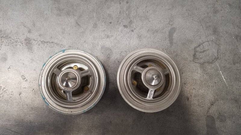

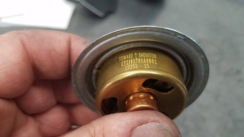

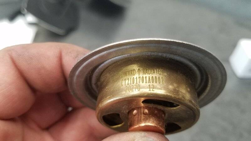

FYI the EMP Stewart thermostat and Milodon are the same. Made in USA by Robertshaw and re-branded. Either one is excellent and is a good choice with any pump.
Milodon on the left, Stewart 305 on the right...
Milodon
Stewart 305
Milodon
Stewart 305
