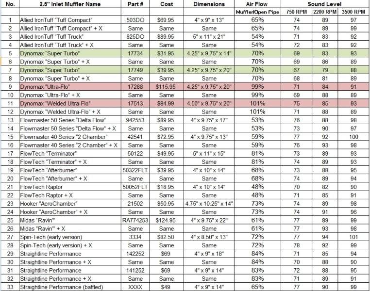

Not a big fan of Flowmasters - I do like the sound but they don't flow very well.
I don't remember which college in Michigan did this test, but they tested the flow values of the major performance mufflers.
They tested the flow of the muffler vs open pipe.
Here are the results of that testing.
Pretty sure that's Tom Hand's test, a member here,VOETOM. If its not, I'm sure he has something similar. He is THE GO-TO guy here for exhaust info.

Looking at Tom's chart above , i would chose either of the dynomax turbos, length determining sound level. Even the ultra flow straight thru are fairly quiet, and out-flow every other muffler in the test.
Dynomax Welded Ultras for the win. Although i do love the sound of Flowmaster 40's at idle, after a couple of miles at cruise the drone becomes a irritant.
Cherry Bomb Pro is my go to muffler now. Basically a flowmaster knock off with better flow directors inside. Engine masters dyno tested as least restrictive.
