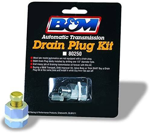

They make drain plug kits. I went to the hardware store and bought a generic automotive drain plug and a nut to match the threads. Find a place on the pan where the plug won't interfere with the valve body and weld or braise the nut to the inside of the pan. Drill the center out and screw in the drain plug.

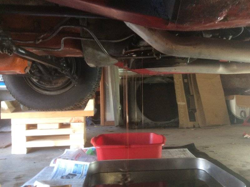

Spilled a few drops.
