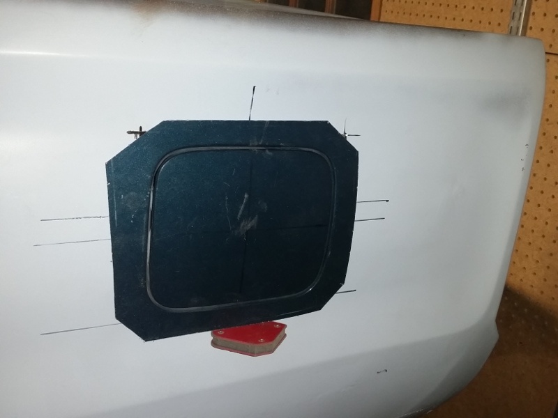

Fabricate the door in from one of the current models out in production . . . Here's my 67 Belvedere Convertible with the fabricated mod . . .

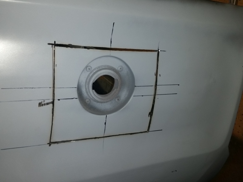

Original gas cap on the car

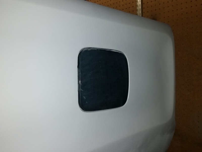

The donor door from a Mada 625 . . . has a handle by the driver door to open the cover . . .

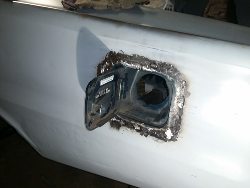

Donor part welded in place . . .
