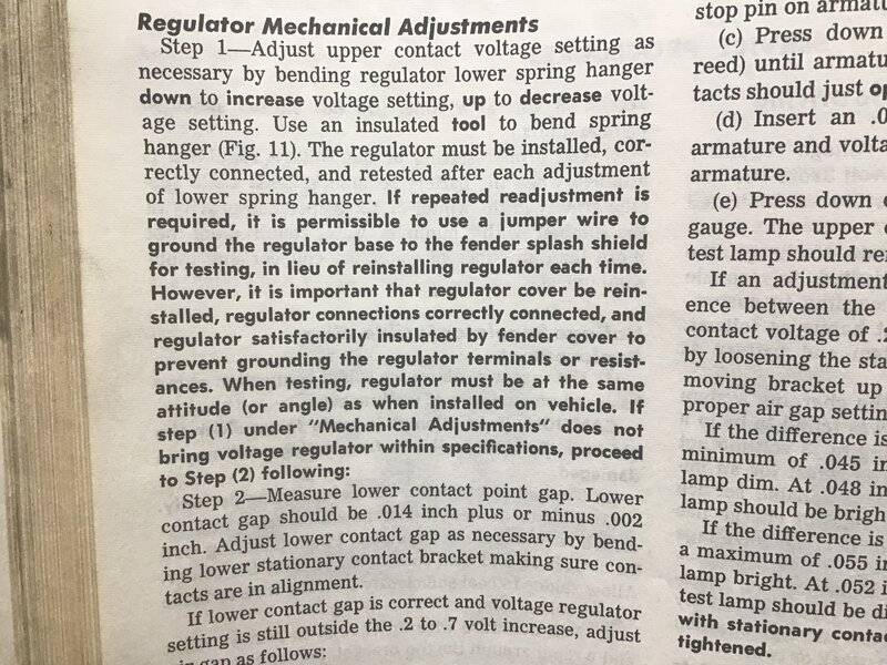

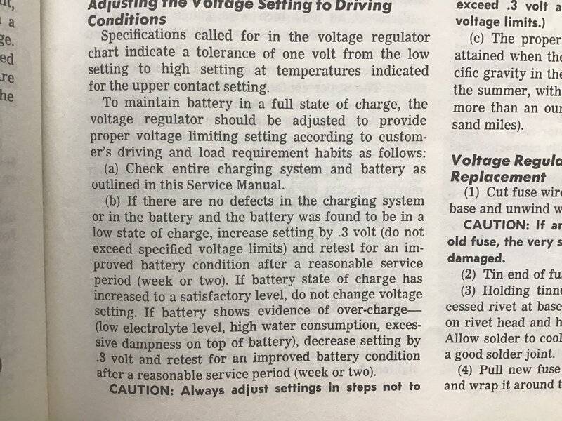

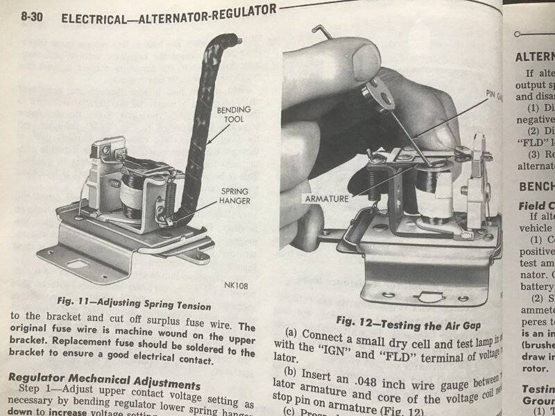

Yes clean the contacts in the regulator. And you know there are adjustments outlined in the service manual, right?
1969 Dodge Charger Coronet Dart book page 8-30

Yes, but I hadn’t thought about cleaning it. May give that a shot as I have a can of Deox in the garage.
I cleaned the regulator with deox and once inside remembered I had it apart last year. It’s a mechanical unit and not exact to the originals in design inside so the FSM wasn’t of much help. The deox cleaning may have finished it off as it would seem to work fine for about 30 seconds after starting the car - showing about 14 volts at the battery. But then it would seemingly stop working, the amp meter gage drop to a slight discharge and the voltage at the battery would go to 12.6 volts. I did this 3 or 4 times with same results. Should have the solid state regulator in a few days so I’m just going to wait on it and hope it takes care of things. Thanks
