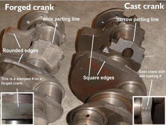

Look at the parting line. A small sharp line is a cast crank and a wide hammered line is a forged. You can tell by the shape of the counterweights as well. Sharper and more blocky, cast. Contoured and more rounded, forged. The forged cranks also sound line a bell when you tap the weights with a small hammer. Quite a clear distinctive ring to them.
