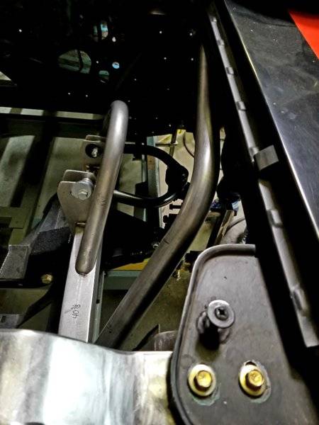

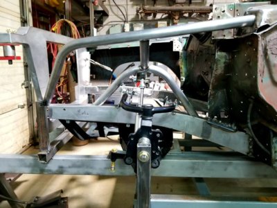

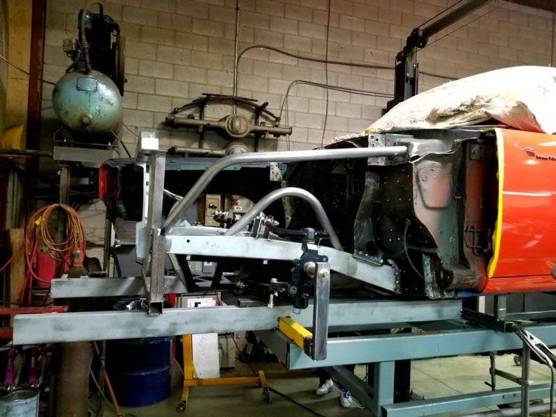

You can see what I did but we also had frame rails made and doing our own inner fenders
I like that!! Outstanding job!
