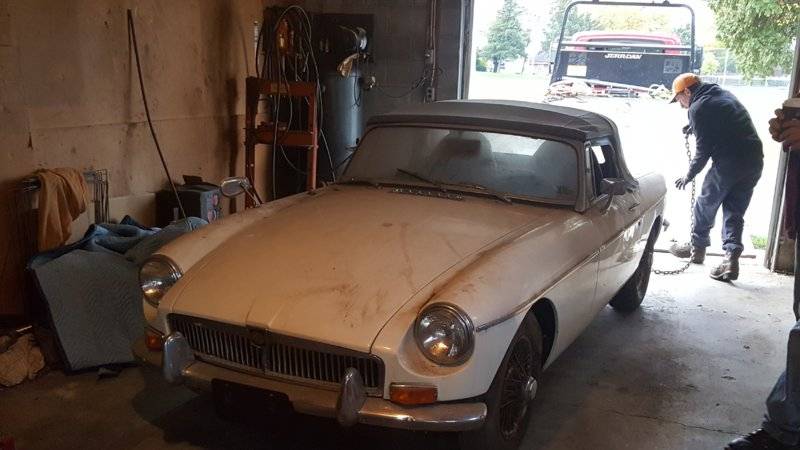

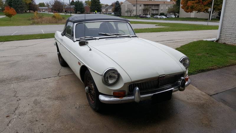

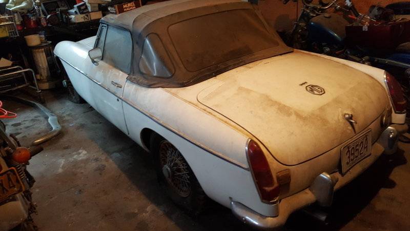

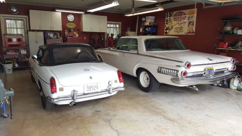

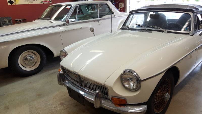

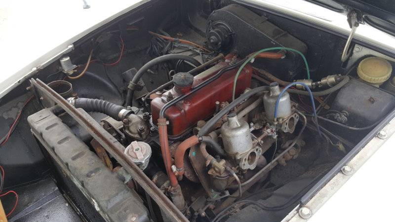

Found this 1969 MGB this week. It's been sitting for 30 years. The owner just stopped driving it. Small rust spot on the driver's side floor pan. The rest looks pretty solid. The engine turns free but I haven't tried to fire it up yet. Have to go through the proper procedures to do that. The price was right so I couldn't resist. :)

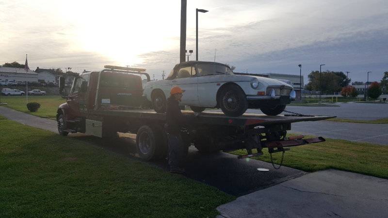

Here's where it sat when I first saw it. Getting it loaded up.

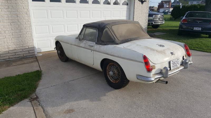

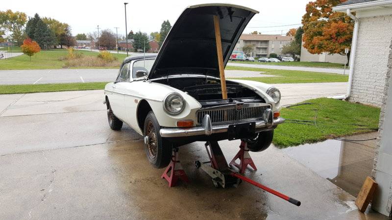

Then getting it home, scrubbing and pressure washing 30 years of crud off of it. It didn't clean up too bad.

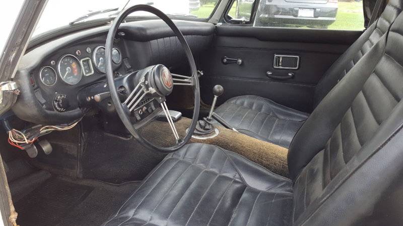

I don't think it has OD. It's hard to tell what I'm looking at but it doesn't look like it has the unit on the tail shaft. I need to look at the engine number also. That will tell if it was an OD setup.
It will have a od pull i think on the dash

Funny thing is most will have the OD switch even if they didn't come with OD. Some had the switch in the center of the wiper switch.
The engine number on this year (and others) have an "R" that states it was a OD. Mine doesn't have an "R". It does have an "H" for high compression though.

I've rebuilt the SU carbs before. I probably need to get the kits before I even try to start it. I'm going to use a "nurse" tank first start up. Also you need to remember to disconnect the wire on the fuel pump before trying to do this.
