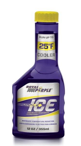

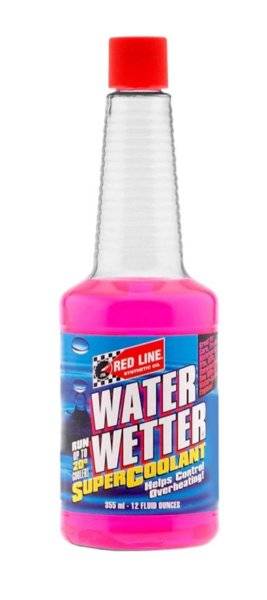

Water Wetter (Redline) , Royal Purple Ice,
and similar products along with STRAIGHT WATER actually is the coolest running solution to put in a radiator BUT
WARNING
Antifreeze MUST be used or corrosion will result.
I'm only mentioning the water+water wetter combo because the topic lends itself to the comment.
The other alternative is a water free solution that runs a little hotter than water+antifreeze, but because it's waterless, also eliminates corrosion altogether in the cooling system.
All water and antifreeze must be flushed completely from the system for the best results when using the waterless solution.
I use 50/50 water and antifreeze premixed, and one bottle of Redline Water Wetter in my Roadrunner and in my wife's GTO.

I’ve used WaterWetter in motorcycles. It works, brings temperatures down roughly 5 degrees in comparison. I quit using it to avoid the risk of forgetting to drain the system before winter. I decided the risk and reward wasn’t worth continuing to use it. A 50/50 coolant/water mix is probably the best choice to cover all the bases.
