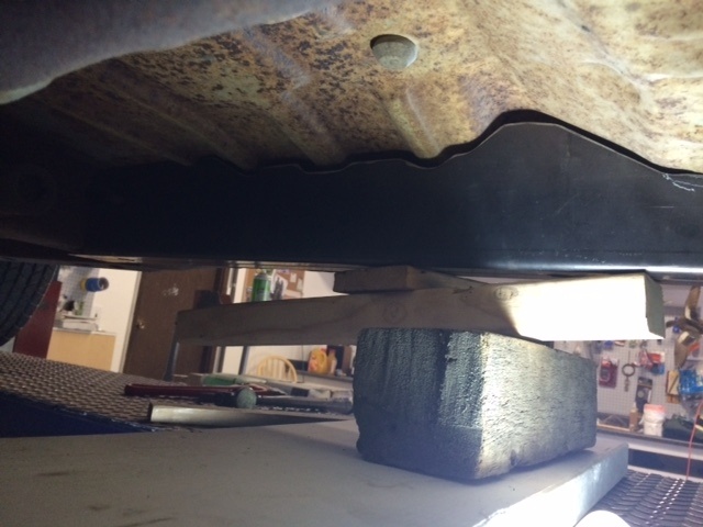

I also used the US CarTools set and welded them in. The only issue I had was the fit against the floor board left me dealing with an amount of reshaping of the pieces to get the gap down to a manageable dimension. After doing a search and reading all the posts on putting them on, I found some very useful tips to make it easier. Make sure your tires are supporting the cars weight before you tack in place and don't be afraid to use a jack or extra weight inside the car to bring the floor and frame connectors closer together for a better fit. With my Coronet, I was reminded from other members that these cars were slapped together and you have no idea how much abuse/flexing the car was put through before you got it. Very satisfied with the results. Good luck!
