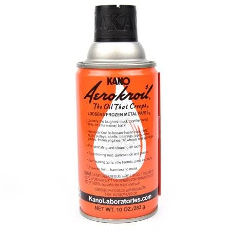

It's Kroil.....penetrating oil. If you have some ATF, that would work too or it should. Might take a bit longer is all...
I had one stuck, it was the wrist pins........had to get at it from the bottom (on a stand)..... took a lot of patience
It's KROIL, not Kroll. Just so you know what your looking for. Good stuff.
Website shown on the bottom of the can.

kano makes kroil and a slue of other products as well . kanolabs.com . check them out .

I do use KROIL
