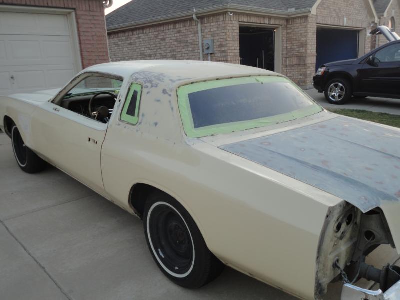

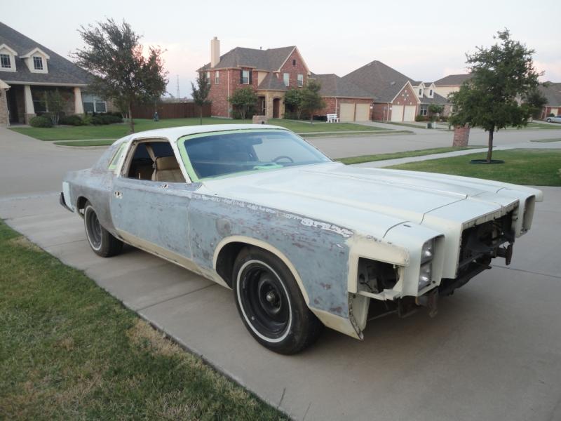

So I dropped of my 79 on wednesday at the paint shop to finish up the work I started so I can drive it again. Started prepping the body a year ago and only get ot drive it around the block since it doesnt have any lights or trim, or even paint on it for that matter. Hope to have it back by the end of Feb and then its off to the trim shop to have the new top installed. I found a place online that had the original 79 stamped vinyl for the roof, so it will be all stock. I am sticking with the original colors and materials except I am goign with base clear instead of the old single stage paint.
It is about 1.5 hours form my house so pics may not be as frequent as I would like.
On a side note, does anyone know where I can get new door seals for it. I have called and searched for the last 2 days and cant find anyone who makes rubber for the doors, only the trunk and roof rails.
So my cell phone pics will not upload, pics to come later.

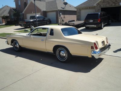

Is that an extremely low srt10 next to the doba in the garage?
Good luck with the car, looking forward to seeing the final results!
hmmm... its seems i saw them somewhere, i will keep searching for you. i have a buddy who has a farm ..yes 13, 75-77 dobas , a 78 and 79 doba, and 2 magnums that he is parting out. i got all my "new" seals off of parts cars for my Charger from him. it was crazy to find out that, out of all those cars he didnt have ONE charger SE lol
send an Email to these guys and ask them sales@topsdown.com
Thanks for all the help guys.
The truck in the pic was actually my old 06 Night Runner RC/SB Hemi, not SRT. I bagged it right where it sets along with all the other stuff I did to it. Dont go to shows like I did so I traded it in for the 06 Night Runner SRT-10 QC ram I have now. Looks the same with 2 extra doors and a viper motor. Good trade for me.

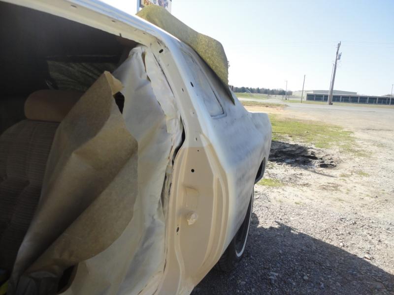

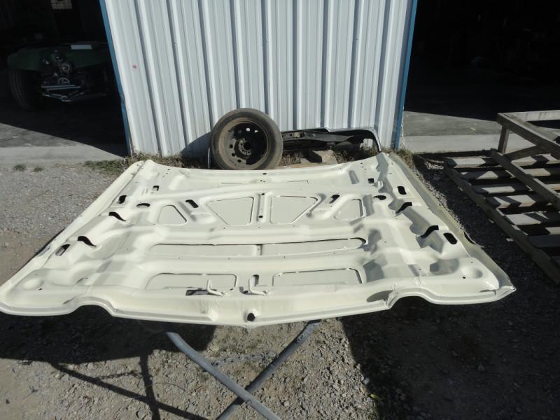

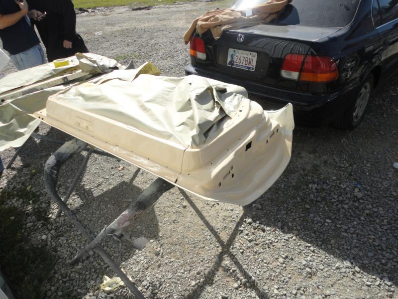

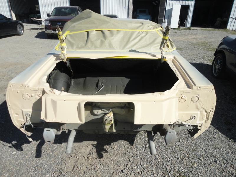

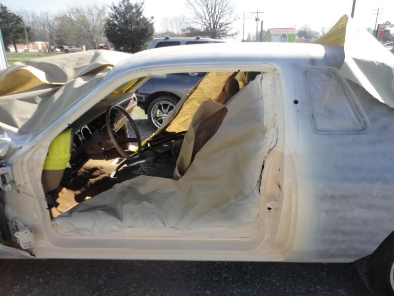

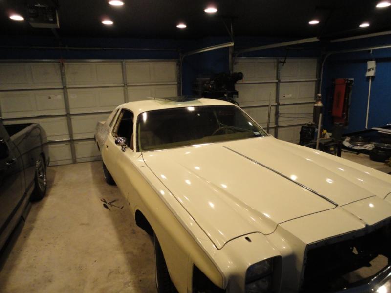

All the jambs have been sprayed and the under sides of the hood and trunk, this friday it will be all painted and pick it up next week after color sanding and buffing. Cant wait, got a garage full of parts that need a place to rest so it will be a mad rush to get it put together as much as possible before it goes to the trim shop on the 26th to get the top put on.

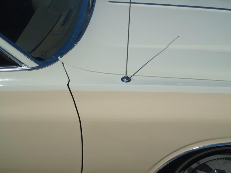

its the factory paint code, linen cream on top and light cashmere on the bottom. The paint shop had to mix the lower color a little different from stock because I want the top material to match perfect and it was a little off from the original color on the car.

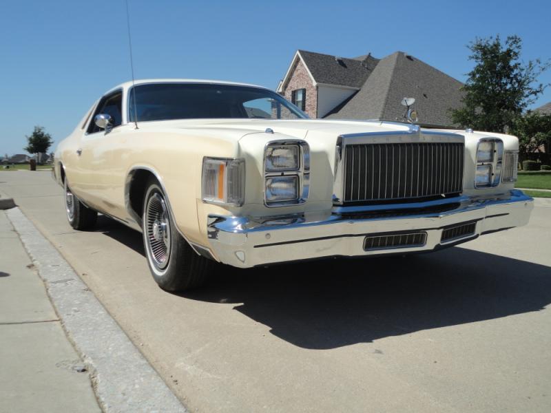

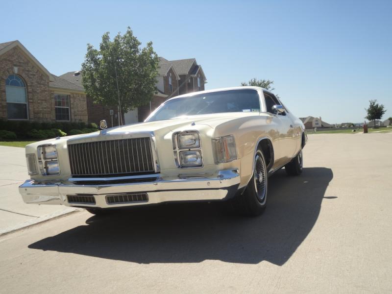

So I got it back about 2 weeks ago and I have had some time to get most of it back together. Hopefully will get it to the trim shop this week for the top and I am waiting on some clips for the lower door trim. I have another new carpet set that will hopefully fit better than the other new carpet I put in it a couple years back. I cant wait to get the top back on it and see it all back together.
I ended up buying some universal 7/8 bulb style weather stripping and reused the upper molded parts that screw to the door itself seems to have worked pretty well, the only problem I seem to have now is that the roof rail molding is new and thicker. When the doors are closed and you go to roll up the windows they try to track to the inside of the rubber which keeps you from opening the doors without possibly breaking glass. If I roll them up before I close the door they seem to be okay, so I assume its just because it is all new rubber and needs time to form a little. The windows are usually up anyways since it has cold a/c.

Love those Premier Wheel Covers! They were such a bargain option back in the day and a very nice cosmetic improvement over the bland basic wheelcovers.
