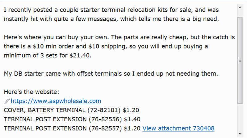

Guys buy starters from here. https://www.dbelectrical.com/starters/automotive/dodge/mini-hi-tor
que/
Stud relocation kits. None mine.
