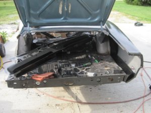

Attached is a picture of how he left it. Passenger side quarter is just hanging and not attached.
Second guy had it for over a year and managed to look at it a lot and do a little welding on a door jamb. Left it like this.

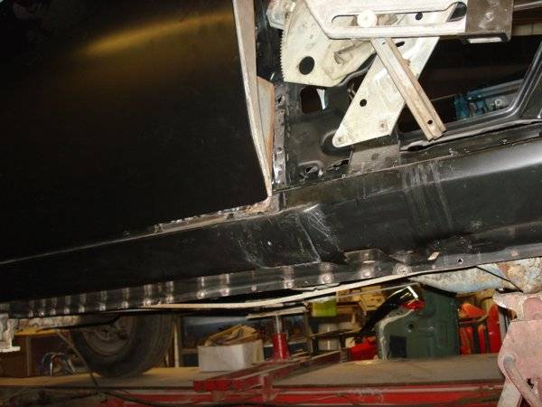

Progress started the last week of January and consisted of fixing the issues the previous shops had either done wrong, or not completed. The quarters that had just been hung on the car were removed and the rusted floorpans were cut out. The LH frame rail was found to have dropped, so the car was anchored and the rail was corrected. The car was leveled on stands and measured for square and they started trimming as needed to fit the quarters. They tweaked the doors, jambs and rockers to align properly and the quarters were rehung and the taillight panel was set in place with screws to set deck alignment. Everything was clamped in place to fit.
The next week consisted of adjusting the doors, fenders, and hood to fit properly and bolt them down. Various tweaking was needed to get everything aligned properly and they started welding the LH quarter to the jamb, rocker and roof. They had to make slight adjustments and patches to the wheelhouses and start welding them to quarter. They then removed the rear panels and started welding in the trunk extensions.

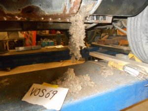

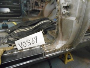

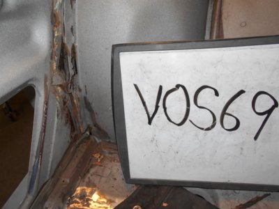

I was able to get a couple pictures sent to me. When looking at the right side, there were a couple holes in the rocker that needed patching, plus they found the whole right side rocker was a huge mouse nest. They decided it was quicker and cheaper to cut away the rusty rocker and replace. Attached pictures I was sent along the way, but doesn't show all the work that has been done.
DSCN0306 (640x480).jpg DSCN2141 (640x480).jpg DSCN2153 (640x480).jpg DSCN2205 (640x480).jpg DSCN2093 (640x480).jpg

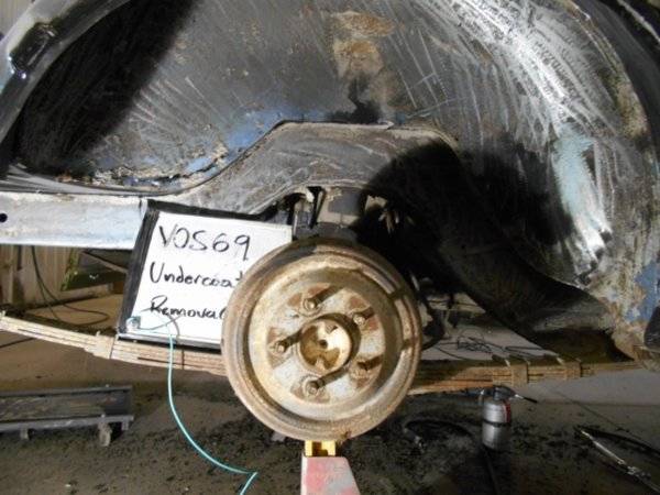

The car was then put on a cart so engine compartment could be stripped (master cylinder, steering column) and front & rear suspension, k-member, all lines was all removed for media blasting. All the undercoating was then removed before media blasting.

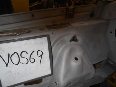

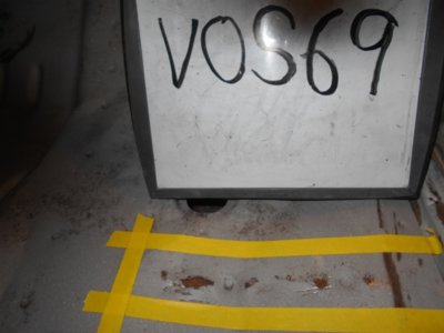

They removed all the undercoating last week and finished stripping the roof, cowl and Dutchman panel. They acid washed the stripped panels and media blasted the body, front and rear window jambs, drip rails, cowl, door jambs, engine bay underbody, and trunk (basically, everywhere on the body/chassis). After cleaning out all the sand and moving it back into the metal shop and prepped everything for epoxy prime. The week was finished out by patching a few spots on the RH inner rocker and welding in the new outer RH rocker and grinding the welds.
I will attach pictures as soon as I get them.

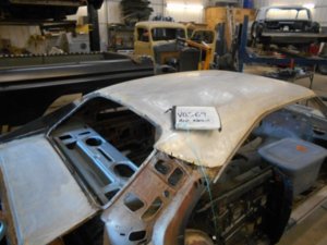

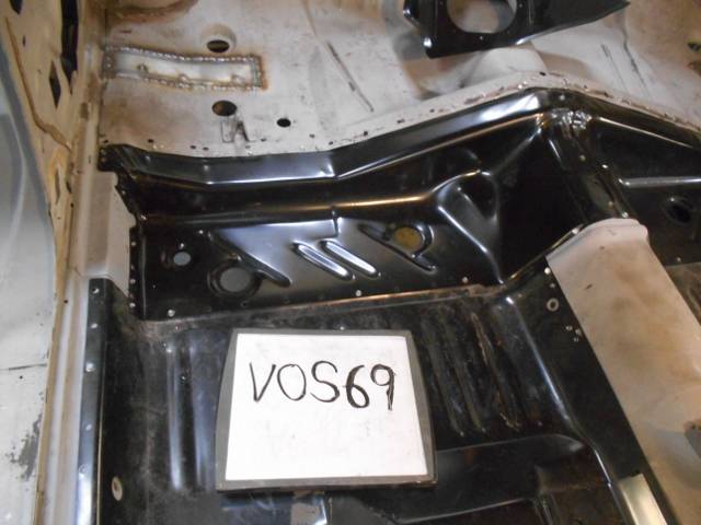

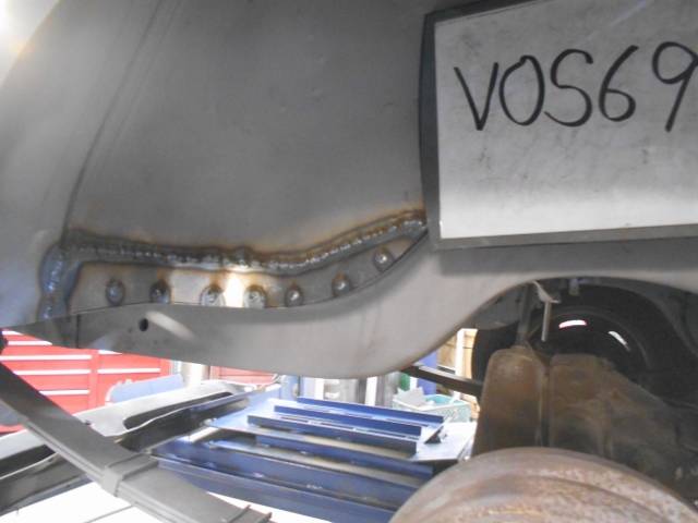

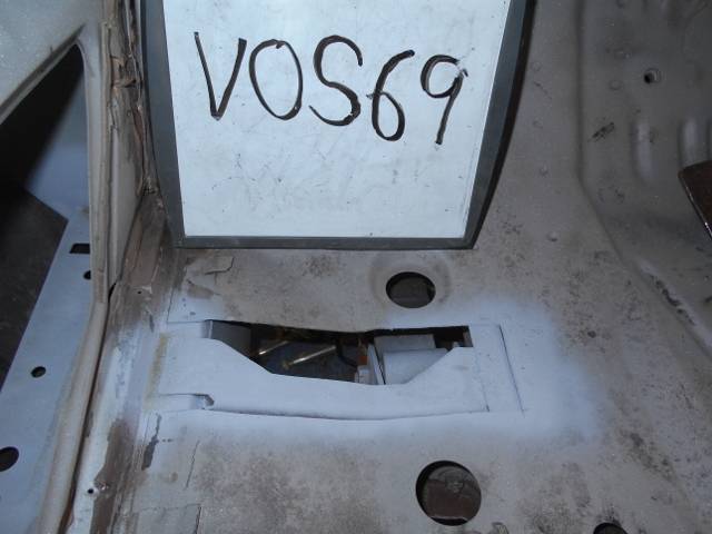

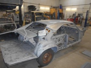

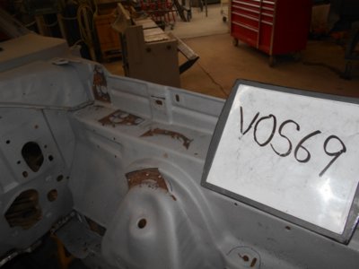

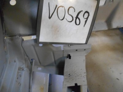

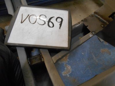

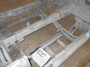

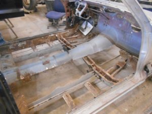

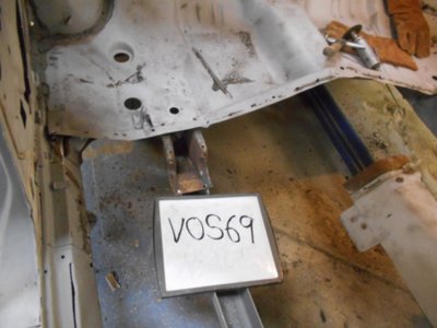

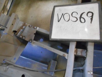

Got some new pictures of the progress. Seems like most of that weeks work was patching areas and reinforcing some spots. Sounds like they DID get the patching complete and the floors going in for good. They had to cut the frame connectors loose and relocate them a bit to get them in the right spot. As of the last invoice, they had the RH floor pans in and welded and were finishing up the LH side. The pictures are a little confusing because they the before and after shots from different angles, but I am glad to see they are replacing all the bad spots instead of just covering it up.
Kind of fun to see the 4spd hump sitting there ready to be installed. I ordered all the conversion parts from Brewer's and will pick them up once they have a transmission ready for me. I will bring it and the motor up to them once they are both done. It will be a full load of stuff going to Minnesota. Kind of sucks having the shop so far away that you can't stop in to see how things are going, but nice to see it moving forward, so you do what you have to I guess.
DSCN2289 (640x480).jpg DSCN2291 (640x480).jpg DSCN2293 (640x480).jpg DSCN2297 (640x480).jpg DSCN2303 (640x480).jpg DSCN2304 (640x480).jpg DSCN2312 (640x480).jpg

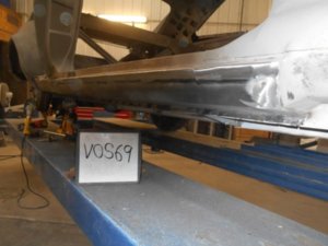

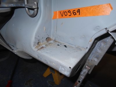

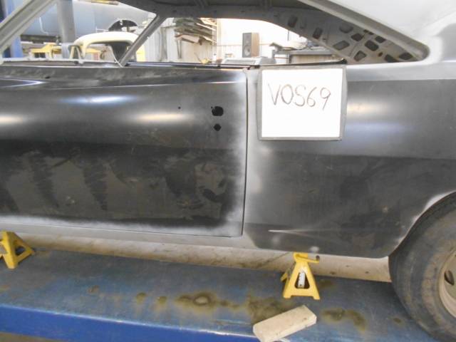

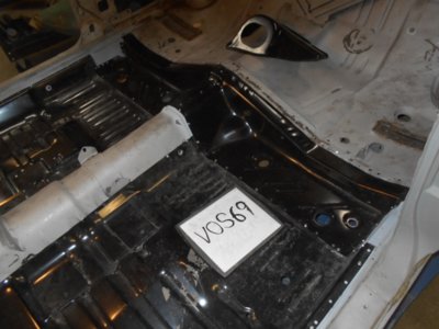

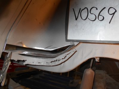

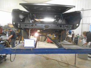

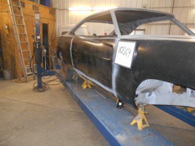

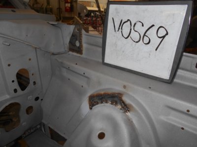

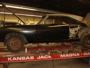

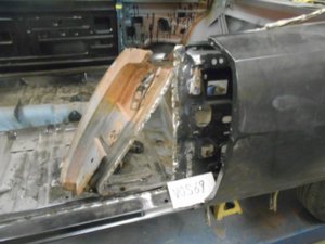

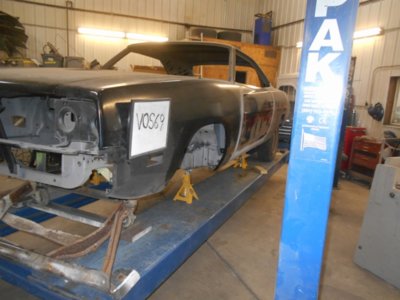

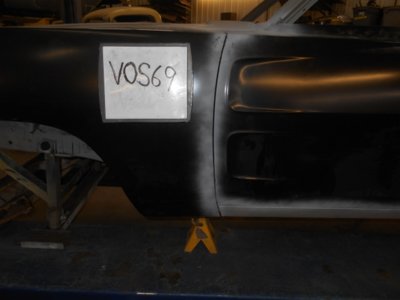

A few more patchwork areas in and around the engine compartment, and they welded in the torque boxes I decided to add for extra rigidity. Don't have pictures of those going in yet, but it's on the invoice so it must be true! :) Fenders, doors, and quarters are back on and aligned. Invoice said they fit the taillight panel and valance, trimmed the valance corners and started welding everything in, but haven't gotten pictures of all that yet.
Here are the pictures I did get though. Lookie there!! It is starting to look like a Charger again. First time in nearly 7 years since the original body guy started cutting everything apart and then bailed on me! NOW I'm starting to get excited!!
DSCN2393 (640x480).jpg DSCN2395 (640x480).jpg DSCN2402 (640x480).jpg DSCN2409 (640x480).jpg DSCN2411 (640x480).jpg DSCN2438 (640x480).jpg DSCN2439 (640x480).jpg DSCN2441 (640x480).jpg DSCN2447 (640x480).jpg
It is amazing what a shop can do once the work starts and the plan is followed through with. It is really sad that the shops that hack a car up and then let it sit for extended periods. It really is a good sight to see that these guys are making good progress and that the thrill is there for you to get the car back on the road and be enjoyed. At the rate that they are moving, if your working on the subassemblies, you can be enjoying the car next year. Keep the work going and enjoy the ride.
