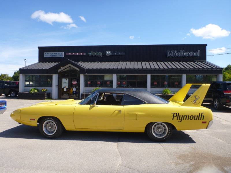

The way a Bird sits IMHO, here's my untouched 56,000 mile ones.

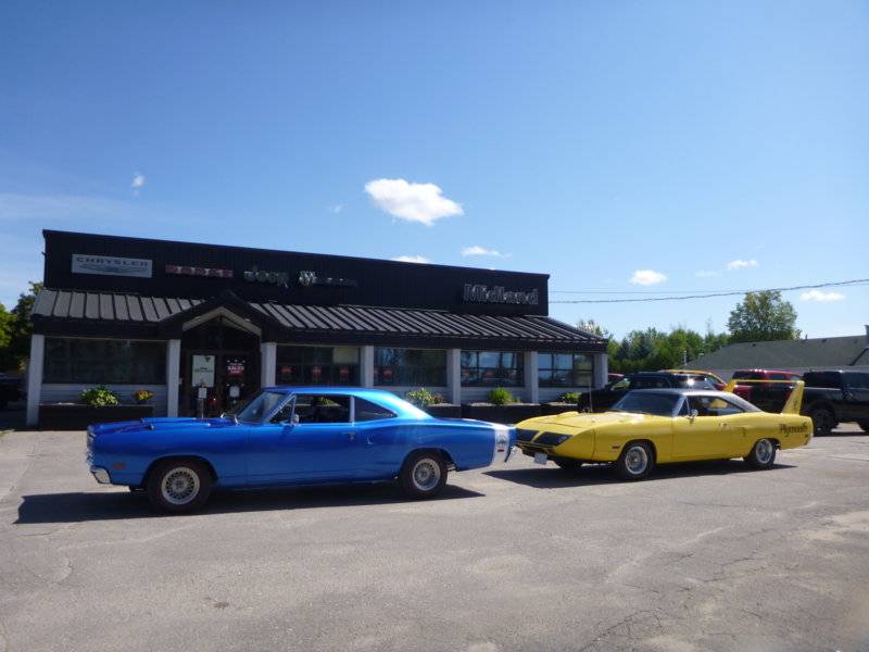

I did take my Bee springs apart and put new interliners, plastic rub plates and clamps on. Those old 156000 mile springs needed air shocks to hold them up before and after I did that they still haven't come down from sitting high. Starting to settle in a bit, but seems to have done wonders.

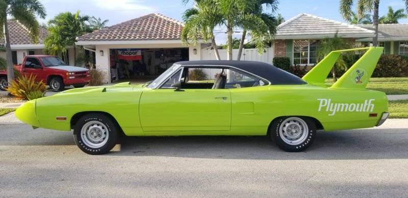

This is my stance. It doesn't look raked to the rear but it is slightly. Seems like it's a little high in the front possibly after seeing the pic above.
Dimensions from my concrete garage floor
The bottom of the rocker at the rear is 10"
The bottom of the rocker at the front is 10-3/8"
The center of wheel well at the rear (center of tire) is 22-1/2"
The center of wheel well at the front (center of wheel) is 26-1/2"
I only have 45K miles. Not sure what the correct stance should be and the direction needed to correct. Either new leafs possibly or a cheap fix would be an air shock lifted about an inch or two...suggestions?
Looks like yours sits almost identical to mine (your nose may be cranked up slightly higher). Part of it is an illusion on the '70. If you look at my Bee and Bird together, the '69 looks like it sits high in the rear because the wheel wells are both the same height and the '70 looks *** low because the top of rear wheel well is a good 4" lower than the fronts.
You may be right. It looks more than it is that's for sure. Specially from my rocker dimensions of only 3/8" front to rear though it appears greater.
Maybe after some new front suspension parts it'll all dial in.
