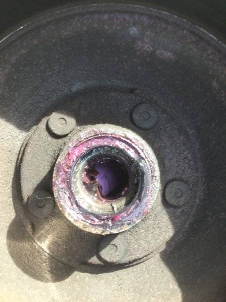

Look real close at the wheel stud where they go through the drums. You'll see a tool scraped metal from studs to help hold drums.
Would they be swedged studs on the '68 ?
Post #233 if they are.

Maybe a deep bi-metal hole saw?
Pressing out a swedged stud may damage the hub splines.

If you feel the need to removed swedged material a touch with a ctoff wheel.
Disagree in post #4?
Those are swaged. As above, holesaw to remove it or, what I did, cut the studs off and center drill them close to o.d. then punch out.
Yup, the fronts are swaged and you will ruin the old drums or damage the hub if you just use the big old hammer trick...
