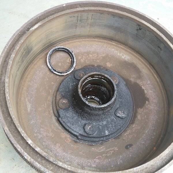

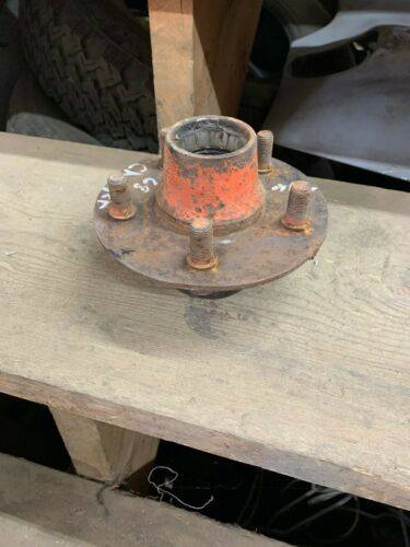

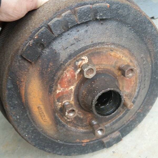

I'm new here to this forum. I have a question on my 69 coronet. I'm doing a brake job on it and I want to replace the front drums. Looking around on the world wide net all I see is drums for sell with out the hub?? Has anyone removed the drum from the hub and how???? I'm posting a picture of the hub and drum together and then just a hub that needs a drum on it. Thanks for the help.
