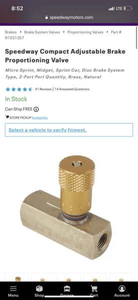

Greetings. I just plumed all new brake lines myself on a 66 charger for a front disk brake conversion. I plumed from the master cylinder to the distribution block. After I spend days pluming everything I realized that I never installed a proportioning valve…..
can I just install one of these bad boys under the car on the rear main brake line and call it good or do I have to completely re-plumb everything?
In the back circuit from distribution to rear
Not sure about that part but think Dr Diff has a good one that will!
The valve can be fitted anywhere in the brake line to the rear brakes.
Most adjustable go in the engine bay after the distribution block so it is away from the road grime and water, and were it is easy to get at.
