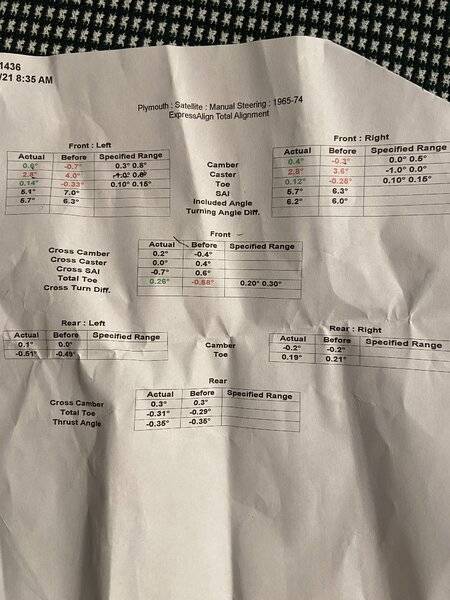

What was your car set at? Caster, Camber, Toe?
I can't see the numbers clearly, but I like -.5 camber, as much pos caster as you can get 2.0 +, pos toe-in .125 (1/8")....
Why did he put so much positive caster in it? Max positive caster is listed as 0 degrees for each side. I used to be a mechanic from the mid 70's to the late 90's and did hundreds of alignments. I learned on a Hunter Lite-a-line just like the one in the picture. I never worked with any mechanics who did wheel alignments who didn't adjust anything that was not within specs that could be adjusted. And where I worked we had a Porta Power and we would bend some that didn't have caster or camber adjustments to get them within specs.
Yep, he set the total toe in to a heavy quarter of an inch. That is a lot and I wouldn't be surprised if it didn't wear the outside of the tires. Back then most were set to 1/8th inch in total toe.
I've always deviated from the factory specs.....especially with radial tires. Positive caster makes the car drive better at higher speeds but you probably already know that. Never have liked the way my older Mopars handled with factory specs.
Yeah, that's a lot. I couldn't read the spec sheet either....but could you? If his car has a lot of negative camber, 1/4" might not be too bad. I tried to keep mine to no more than 3/16's with all the camber I could get and tire wear actually surprised me but my tires weren't all that wide...235-75-15's on cop car wheels. It handled pretty decent for not having sway bars on it.
There is a thing as "Total Toe" I can't read that photo of the settings you sent..Anyway total toe on the old mopes can go as high as 1/4'' no problem.
Even 3/8'' total on bias tires.
By the way on the new computerised alignment machines,They red X all my specs that I use.:BangHead:
My buddy has a $100,000 alignment machine at his bodyshop. It hates me....:cursin:
A 100,00.00 dollar alignment machine?
I like the way the numbers look. That is very close to what I set my 65 to. I do have my camber set to 0 on both. Caster I set to left 2.2 right 2.5 to compensate for road crown. If I had power steering I would have set caster higher. My toe is at .2 and I have little to no tire wear and my car drives straight.
I would have put more caster in it.... Looks like 3.5 was attainable... 0 caster is fine if you drive like Grandpa and only run Bias Ply tires.... Caster is not a tire wearing angle and more caster means the car tracks straighter & the steering returns to center crisply.... And more importantly positive caster helps to create increased negative camber on the outside wheel during cornering... Negative camber plants the tire better allowing greater cornering load without slippage....
The numbers are pretty good and a reasonable compromise....

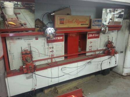

As far as the Lite-a-Line just make sure you don't have it next to a big plate glass window cause the out side light can effect the accuracy of the machine...
IMO the Hunter with strings worked allot better... and honestly I'd prefer an old school set of snap gauges...

I copied the picture to a file and then blew it up so I could read it. He has camber set at +1/2 on both sides which is dead center of the specs.
