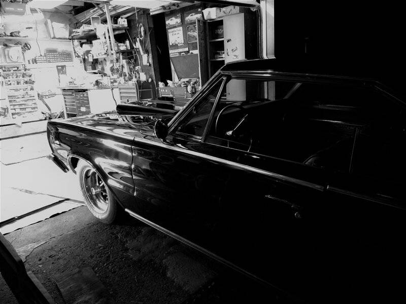

Glamour shot after driving around the block last evening
