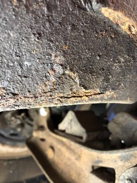

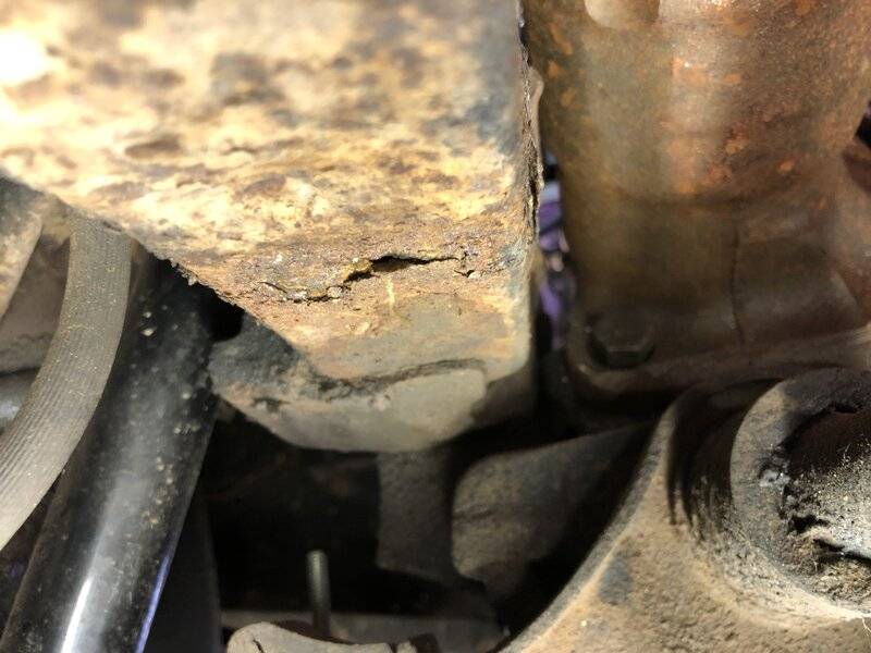

I’m working on my 71 Satalite I’ve had since 1979 and while removing the headers I found more rust on the left front frame rail just behind the K member. That rail has been patched once already so I’m thinking I’d rather swap out the entire rail. Looking all over the internet I can’t seem to find anything other than 70 down and or E Body parts. Now I remember reading that 71 E body front rails can be on a 71 B body or where I can purchase the correct frame rail or Safe-T-Cap. Any help will be appreciated.
There are a few small minor details different between the E-body & B-body. The rail will fit from an Ebody. I put a Goodmark rail in mine & it was listed for both. The differences were a blank hole up front, different shaped flange on the front of the horn corner, and the battery tray hole location about 3/4" off... Dont use a safe-t-cap. Do it right & be done.

Thanks so much for the reply, I had herd they would but I was hoping to hear from someone who tried, if I can’t find a good used one I will go that route. I’d like to do t right as the other three rails are spot on, no rust at all.
