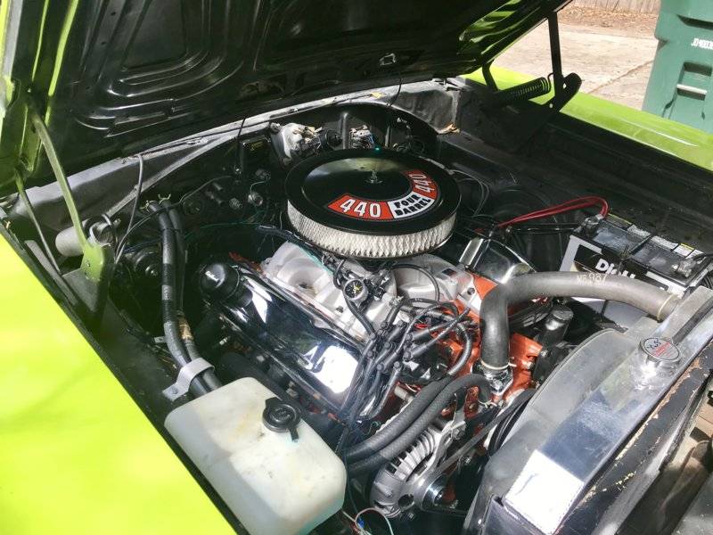

Front of air filter soaked with fuel

All of a sudden today my engine started running very rich (I have an air fuel ratio gauge) over 55mph, bogged down and nearly quit, and the front of the air filter is damp and yellow with fuel. What could cause THAT? Stuck needle or float? Blown power valve? Too strong a squirter? Cheap fuel pump over pumping? Choke?
It’s a new 650 brawler carb. Only happens during off idle cruise over 55mph. Also went from good afr .95 lambda down to .8 and less under off idle cruise for no reason. Engine Cut off when it dropped down to .7 afr.
The car has been great for 2 weeks, then out of the blue, it bogged and barely idled to a stop and ran consistently rich. Sat 1 minute then drove off and it happened again several times over 55. Did fine at idle and under 55. Thoughts?
This was the first 85 degree day since engine was built. I tuned the carb with temps less than 70 and also with a 160 degree thermostat. Should I put the 180 degree in it, let it get hot and re-tune it (primary jets) for summer temps? Engine runs at 160 typically, went to 195 today in traffic but came down quickly underway.

check your float level. Could be too high, then higher fuel pressure from higher RPM (assuming mechanical pump) causes overflow, possibly out the vents. Just a guess. Not a power valve, that would leak out the bottom and all the time the engine is running.

I’ll recheck but fuel level was half way up the sight glass.
Splice in a fuel pressure guage and bring the rpm up to freeway speed and see what happens. I have 2 holleys on a tunnel ram. Was blowing past the needle and seat left and right. Was changing em out. First this bowl than that one. What I finally found was this little chrome cheapie fuel pressure guage I was using was reading 3 lbs light. So 7 psi was really 10 psi. What a be....ch.
The mixture richening up some when the weather gets warm is normal, puking gas is not. Double check those float levels first, that's the easiest. It seems as though something's plugged or stuck, I would get a rebuild kit, disassemble the carb, and go through it...it's easy and that will either cure it or at least rule it out. If it persists with new parts look toward pump/pressure issues. Remember--just because the carb is new doesn't mean the internals haven't degraded, it could have been sitting on the vendor's shelf for a long time. My Demon sat for a long time and when I finally got the car running, the pump diaphragms leaked bad.
I'll practically guarantee your primary needle and seat is blocked, which is causing fuel to back up and erupt from your vent tube at that rpm.
I "think" lionized, badvert & others have this right. You have extra fuel getting into your carburetor primaries for sure. So, you either have a piece of dirt or something in the needle & seat keeping it from closing all the way (very common), your front float level is too high (most of the time you want fuel just to the very bottom of the sight glass), or your fuel pressure is so high it is forcing fuel past an otherwise good/clean needle & seat. Stock fuel pressure is about 5psi & at 7psi or so you can start having the issue you describe. HOPE THIS HELPS!

Finally got around to checking out the carburetor. The float level was fine, fuel pressure 6lbs, and the needle and seat was also fine with no debris.
So I began to think what did I do in the past two weeks that could make the air filter wet with fuel. The only two things I did, was a. install the vacuum advance on the distributor, and b. removed the small pink pump cam and replaced it with the massive blue one and went from a 31 nozzle to a 35 chasing a bogg. I think “b” is the problem. I can remember actually hearing the pump shot hiss over the engine running when I hit the accelerator. I think it was giving me way too much light throttle pump shot over 55 miles an hour even at light throttle movements. I’m hoping that coupled with a 85 degree day caused the flooding.
