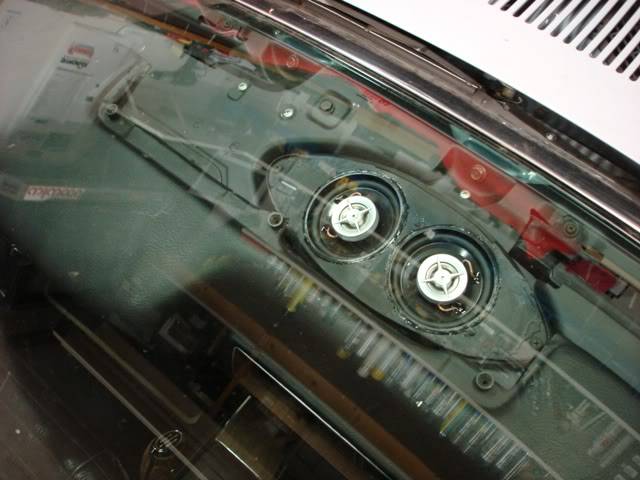

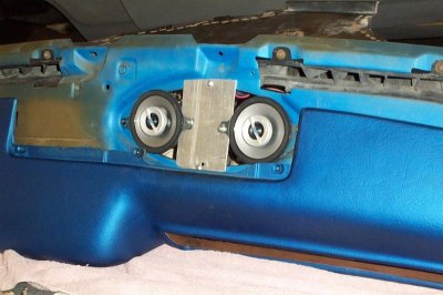

Same concept but using a stock speaker frame to avoid additional holes in the dash frame. Angled away from each other slightly to attempt to get a little separation in the windshield sound reflection. As mentioned, don’t expect a lot of bass, a good quality coaxial will give pretty good mid-high end response however. Just couldn’t bring myself to cut holes in the doors on this one.
BTW, with any speaker installation, if you seal off as much as possible around the perimeter of the speaker, as far away from the speaker as possible, you will slow the rear pressure waves from reaching the front pressure waves and cancelling each other out, killing bass response. This will maximize what little bass this small speaker can reproduce, not that it’s a whole lot. A plate cut to fit the 4x10” opening completely, then a holes cut to fit the 3 ½” speakers, with a thin foam gaskets between each will perform better than bracketing in the bare speakers. You will never be able to seal off the entire dash frame air tight, too many other openings like that defroster vent.
72's is a more professional approach. I wasn't too concerned about spearker seal on these as I was going to cross them over at about 500Hz and have subs and other mid drivers.
Either way, having dash speakers really fills the front center of the car.

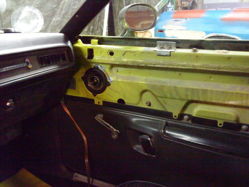

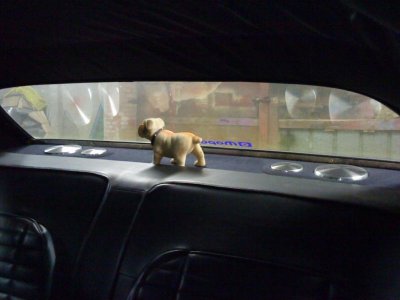

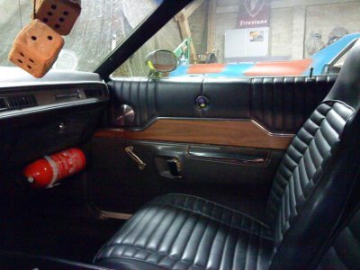

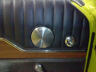

Here is where I chose to mount my speakers in my 71 RR. I have 6x9 coax- units in the parcel shelf providing more than adequate bass levels. In the front I startet with two 4" coax-units in place of the old 4x10" unit. This I never really got to work properly since you get stereo from the center front and then proper stereo from the back corners. This really made the stereo perspective muddy and tiresome to listen to. Maybe it is possible to make it work but I couldnt!
Instead I mounted the two 4" coax-units in the upper door panels as you see in my photos. Now stereo imaging is really good and the sound rocks.

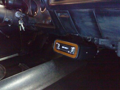

As far as a deck goes, my advice is to get a basic one with an AUX port put into the glove box. Then connect an iPod/MP3 player to the deck with a cord, set the deck volume high, snake the cord out of the glove box and close the glove door without crimping the cord, and use the player to control the volume. This way you get modern convenience of tons of music in your car, with no visible alteration in your dash. The shop that I had do the install did have to cut into the back of the glove box to fit the deck- outta sight, outta mind.

Hey Capsule those speakers in the doors look right at home there with those stainless speaker grilles...nice job.
