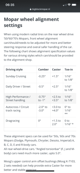

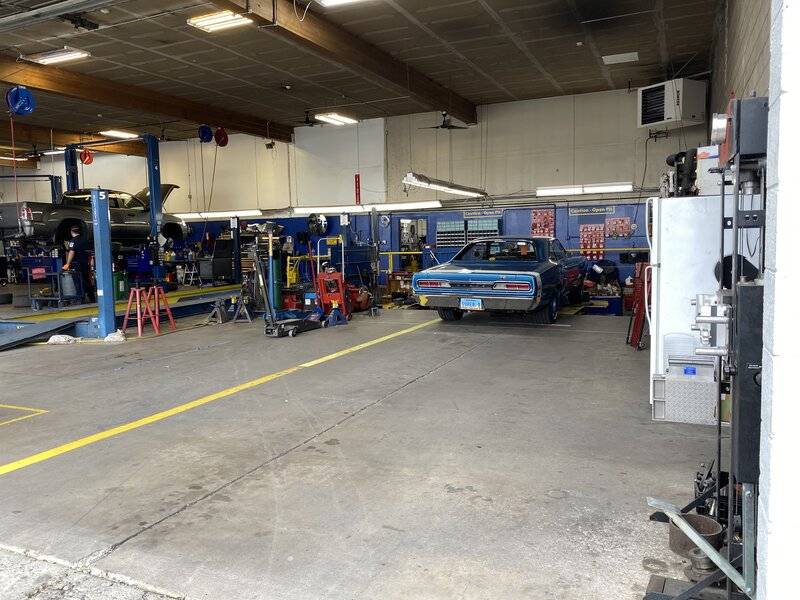

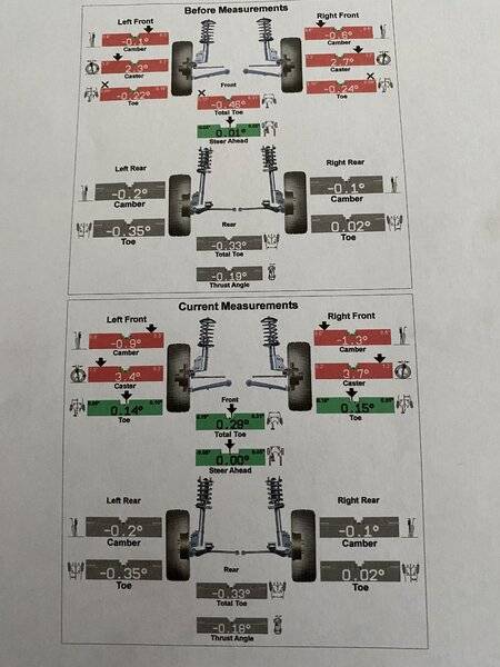

I’m running the same size front tire on a 8” rim. Here are specs I found online plus the printout from when I had mine set. I have stock control arms.
DAFE0D1F-42A0-4331-BC6C-ACCC1516C950.png BA8BA521-D9D3-4C06-BF4B-3091013C14CC.jpeg A329B0CB-73D4-4956-9897-89CDA42892F9.jpeg
Are your front tires close in size? I had yo bring it back, and have it adjusted. As they showed wear in just a few miles. I'll let the shop know. Thanks
Yes they are. If you had to go back they did something wrong. The print out tells the story.
Depending on what bushings that are in your car and the desired ride height the range of adjustment can vary. Your car can also be made in such a way that adjustments beyond the factory settings may not be possible. I like to see the right and left sides be as close as possible to the same.
Upper control arms are new, all bushings, ball joints are being changed. So it should be pretty much stock.

You should be ok. Most of the time to get more positive caster you need the off set upper bushings.

Yep. You’ll run out of positive caster before 2.5 with stock bushings. Go as high as possible keeping the sides the same. I’d keep the rest of the alignment specs same as factory.
