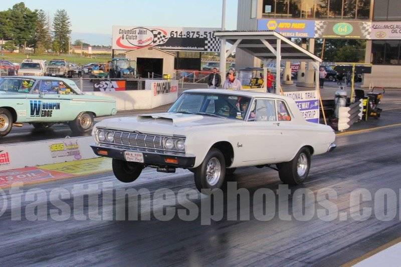

I have a 64 Plymouth Strip/Street car. I rebuilt front end 20 years ago with stock replacement ball joints and bushings. The torsion bars are original 318 bars. My problem is car is very inconsistent. With my old 440 car on typical day could vary from 11os to 11.20s 60ft 1.52-1.58. Car always ran good, MPH was always close. I think it is suspension problems, so I put new SS springs with solid bushings on back plan on Dbl adjust shocks all the way around. But for front not sure what to do. I haven't really looked at front yet just trying to get ideas. Would you use rubber replacement parts. What advantages to tubular control arms and are they worth it? The car has gone from a mid 12 sec car to 11os. Now I have a new 505 and hoping for 10.50s. I don't get to make many runs a year so the faster I could figure this out the better. The car only sees 100 street miles a year.

My 64 runs 10.30's, over the last 5 years I have went from dvorak leaf springs with stock long shocks to caltrac mono leafs and 9 way adj, rancho's no change in ET but have some adjustablity for bad tracks. Stock front shocks to calvert shocks, again no change. Went to QA1 tublar upper control arms from stock, no ET improvement. I am just saying if it's not spinning the tires none of these upgrades are going to produce miracles. I have seen inconsistant ET's caused by throttle not opening all the way, converter problems, shift points, brakes dragging. Take a close look at everything hopefully you will find an easy fix.

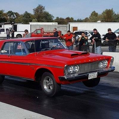

My 63 Sport Fury is a street car that sees the track once or twice a year. I run basically all stock suspension as I use 3400 lb SS springs in the rear with the longer extending non-adjustable shocks. Up front all suspension is stock other then the 90/10 three way adjustable Comp shocks. I like all the fancy parts and they can save some weight but I am on a tight budget and stay with what I have and it works good for me. Car is very consisdent as it ran 10.76 three passes in a row a few years back. Best runs are 10.70's with a 1.50 best 60 and I drive it to the track. I feel all the more modern suspension is good but you can still have a nice working car with mostly stock suspension for a 10 second or slower car. Good luck with yours. Ron
