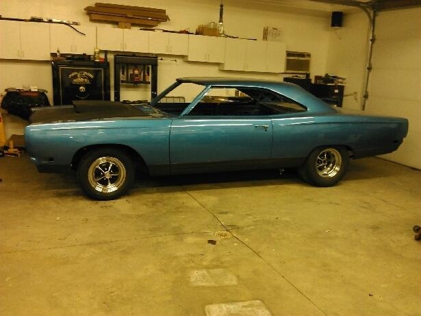

15x10s with 325/50/15s in back and 15x4.5 front with MT sportsmans 26" but think I'm going to change to 28s
The engines not in in this pic so the nose will drop about 2"
