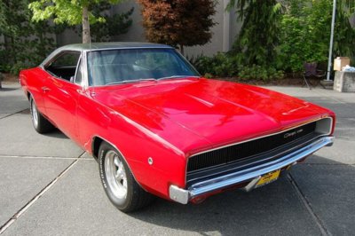

'68 Charger.. going with 15x8 4.5 BS on the rear .. what about the front to fill the well. More offset ? or less BS. .... drum brake car.
Also thinking of 70 series for the rear anyone use them.

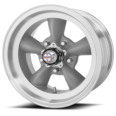

15x8 with 4.5 bs seems to be the sweet spot on a b-body. They will probably work on the front too. If you want a narrower wheel for the front, i would try for a 15x7 with 4" bs. American five spokes seem to be common at 3.75 bs, but i would swear that mine are 4". (Now i have to go back thru my records, which are a couple hundred miles away).

Thinking 255x70x15 .. 4.5 bs for the rear.. front 60 or 70 series. like to get it to the outer edge . Maybe 235 with a 15x 7 or 8 with 3" BS ?? front.. Want to get it right the first time ..for a change.
