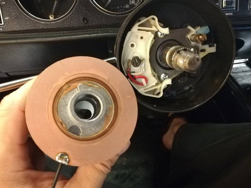

I would try to turn the adapter on the car with the cover removed, prob see something.

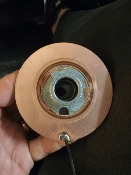

Which Grant adaptor disc did you use for the horn ring? You may have the wrong one - the selection is very difficult to make as they don't give all applications clearly.
I ended up with one I don't or can't use thanks to mis-information.

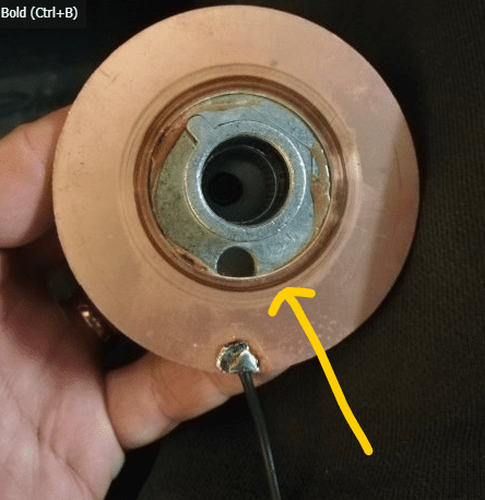

This is my adaptor:
Ok, no noise when battery is connected.
No noise when key is turned on.
So this is only when the car runs (Didnt want to start as wife was sleeping, will test more later.)
Adaptor and switch looks good.
Im gonna get a new switch and try, there is a car meet coming up I wanna go to.

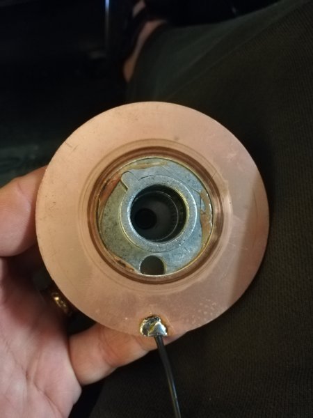

You can actually see the wear already on the inside of the copper disc...
Is the head of that solder joint contacting anything like the red terminal point or the plastic of the turn-cancel mechanism?
