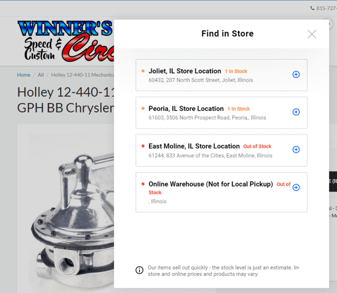

There's this..........
Holley 12-440-11 Mechanical Fuel Pump 110 GPH BB Chrysler - Winners Circle

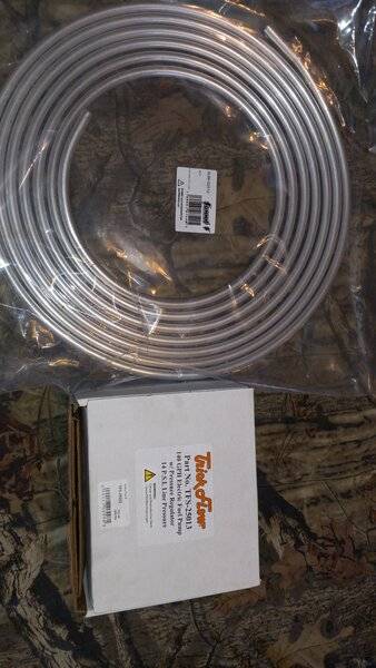

I am I the process of replacing a car-length of braided line (rubber inside) that leaks like a sieve, with a 1/2 aluminum line, with A/ N fittings, to duplicate the setup (1/2 aluminum, a/n) that has lasted for thirty years on my other car. Also replacing a leaking holley blue, with a trick flow 140, again like on my other car.
The pump isn't quiet, or loud, just average, but I can't hear it when the engine is running.

Probably true... but the 1/2 aluminum fuel line I used on my car hasn't leaked a drop in thirty years. Sure can't say that about the stainless braided rubber hose I have been replacing every couple years. Using nothing but teflon hose for flexible connections from now on. I have finally learned my lesson.

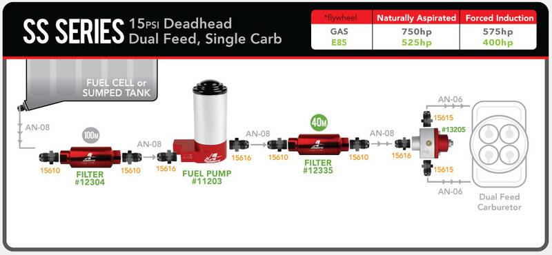

I used Aeromotive products on both of my cars. The SS series is good to 750 hp. My 65 has 750 hp and the fuel system works fine. Like Bob Renton suggested, I went through the calcs previously to estimate the fuel required for 750 hp and the Aeromotive system meets the requirements. I use -8 braided hose from the tank to the pump and from the pump forward. I also used a bypass regulator and -8 return line rather than dead heading. The pump is mounted on the frame rail near the tank. I used a 1/2” pickup in the stock tank. The pump makes some noise but I don’t hear it once the car is running.
I used Aeromotive products on both of my cars. The SS series is good to 750 hp. My 65 has 750 hp and the fuel system works fine. Like Bob Renton suggested, I went through the calcs previously to estimate the fuel required for 750 hp and the Aeromotive system meets the requirements. I use -8 braided hose from the tank to the pump and from the pump forward. I also have a -8 return line rather than dead heading. The pump is mounted on the frame rail near the tank. I used a 1/2” pickup in the stock tank. The pump makes some noise but I don’t hear it once the car is running.
How is your return line routed? Out of one of the pressure sides of the regulator?
The schematic shown is for a dead head system. A return style regulator is needed for a return system.
