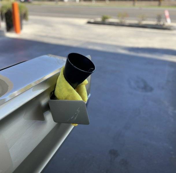

keep a funnel and a few clean rags to keep the paint pretty
go half trigger and keep your eyes looking down the funnel
a few rounds of practice helps
