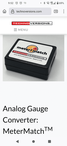

Try this:
https://technoversions.com/

The gauge and the sender have to be the same ohm range for it to work. If it's programmable and you have it set on 10-73, but you're reading 93.9 ohms from the sender, it won't work. I can't tell from your posts what the sender can send.
