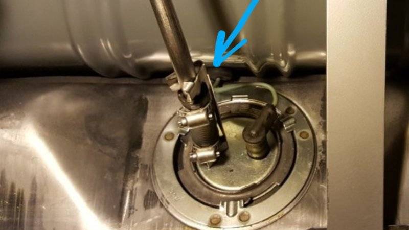

Remove the lead on the sending unit and ground it. If the gauge goes to full, the trouble is the sending unit or the ground strap. Quick enough to find which direction the trouble is.

Should be a clip on the fuel line that bridges the short piece of rubber hose. That helps with the sending unit ground connection.

My float was only about a year old. Part of Chinese repop sending unit assembly.
About a year later the fuel gauge stopped working. Test and narrowed down to the sending unit.
Pulled it out and sure enough the float had 2 fairly large holes. Float sunk.
Combination of Kalifornia alcohol in fuel, not running the car enough which let the alcohol absorb water.
That rotted the float.
Replaced the float with a genuine brass OEM float and, tada! works great.
