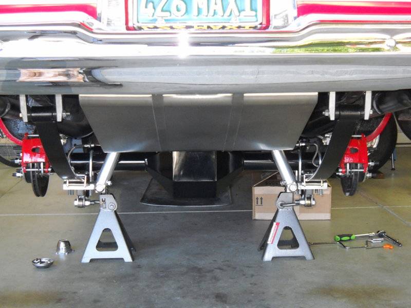

Those are really nice tanks, but if you have some time, you can use a stock tank and get an intank pump.
A lot of retro kits out there using a stock tank, Aeromotive, Rhodes, Holley, Fitech, Tanks Inc.
Priced one for mine from Mopardude a couple of weeks ago with a 450lph pump was going to be around $1500....very nice stuff though.
I used a stock tank and then had a notch welded in for the pump. Pretty easy stuff for a street rod shop. They do this type of fab work all day long.
Back around 98-99 we did Fast Fuel Injection small block Mopar using a GM Corvette in tank pump on a A body. The system used 38 lbs injectors.Drilled stock pickup for wires and return.Attached the pump to the stock pickup tube.Inserted in the stock location.Hardest part was the sealant for the wires that was fuel resistant. ( It's too long ago to remember what was used.)Return was a O-ring type balk head fitting. Worked well. Drove the car on the Power Tour from L.A. to Ohio and back.Was still going strong when I sold the car. Just a thought.

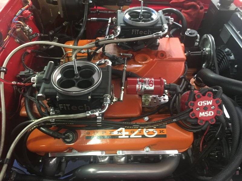

RC think someone did Fi-tech throttle fuel injunction throttle bodies on a crossram maybe they'll chime in. Maybe call Fi-tech tech line.
Here's the link to the company that did mine: https://rickstanks.com/
They're in El Paso. Fast service and great quality. I have the 63 Fury with a crossram and dual FiTech throttle bodies.
