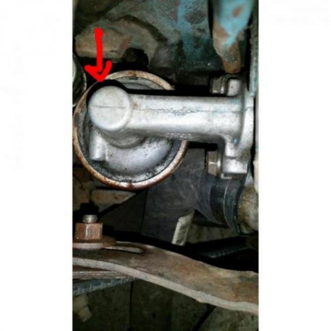

When ever the 73 318 charger se is running it has a spot that fuel squirts a little out of. It's almost like a screw should go in the hole or something to stop it from spurting out but I figured I'd ask first plus any screw I try won't fit (it may not be threaded). Any ideas on what the hole is?? I have it circled in the pic sense It's on the other side and can't be seen.

Ya need a new fuel pump. The diaphram inside is leaking. Should run better with a new one too.
Check your oil too. It could be pumping gas into the crank case.
