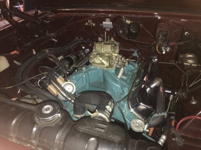

I'm adding A/C to my '70 Charger and the change of placement of the alternator requires me to replace the fuel line from the regulator to the dual feed fuel rail on the RH side of the carburetor. I have the regulator mounted to the frame rail near the pump. The original routing was sort of like this:
The fuel did not boil despite being routed near the alternator and heater hoses. The line in the picture is for mock-up purposes only but is close to the shape that I am considering. The advantages of this to me is that it is hidden, looks decent and it has worked before.
The downside: With the additional heat from adding A/C I wonder if it might not keep the fuel cool enough. I have a thermal-sleeve that was on the line before that I could use.

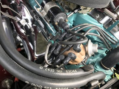

Below is another route. It has fewer bends, is out of the way of most everything but to me, it doesn't look as nice and I have concerns about the possibility of fuel leaking from the filter being that close to the distributor. It seems like a high risk of fire.

Another option is one where the fuel rail is joined closer to the center of the carburetor as compared to this one with the gauge and inlet at the front. The middle style would move the filter and gauge away from the distributor but does anyone make a 3 sided 3/8" fitting with a small port for the gauge?
Why do you have the coil mounted like that? Normal pad on the intake works fine. If your afraid the coil will 'leak', the dang thing needs to be tossed anyway.
Fuel line routing...neither!
Why don't you route it, like it normally is? Whatever pump your using, get the length of steel brake line tubing. Yeah, it can easily be shortened, after it's bent.
From the pump, across to the front right side of the block, and up from there. That keeps the line away from the exhaust. Up the block, in front, and around the base of the distributor, with a final bend towards the carb line, and filter.
Pretty much like the factory routing. Sure, you can add a thermal-sleeve to it, no prob. It will look much neater. A little bit of a pain, but worth it.

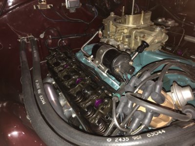

The coil is mounted vertically because it clears everything. I had it mounted THIS way:
But the MSD instructions advise against mounting their coils horizontally. The coil did fail mounted this way. I changed to another coil and mounted it vertically since then.
Also, I wasn't sure if the horizontal mount would be in the way of the A/C compressor so I just tucked it back out of the way.
Okay. And, why did it fail? The big question.

I've never liked the location the conventional Holley style carb fuel line connection joins to the rest of the fuel line, aiming right at the distributor. This last time I went all braided stainless right to the carb, which worked well and is pretty clean. If you do that, it opens up your options.

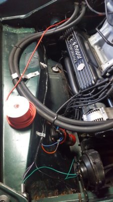

Yup, and the heat doesn't help, and with little room to mount vertically I put mine on the inner fender.
Vertical, cool, right next to the dizzy, and cleans up the cluttered manifold.
I also made a harness for the coil, horn, and alternator wiring and mounted it on the passenger inner fender. Used the same factory clips as on the driver's side.
Only pic I have on my phone is during the process, but really cleaned up the engine.
