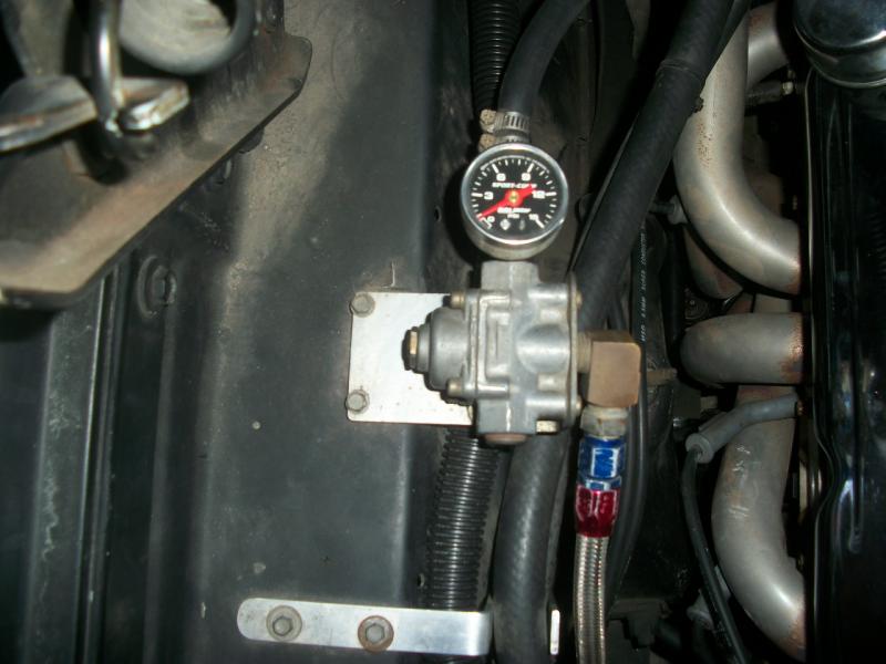

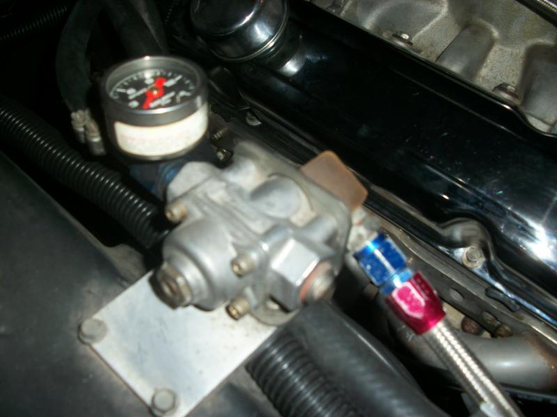

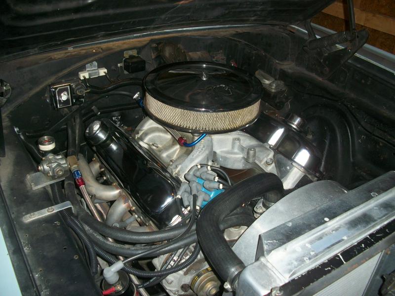

I don't know what the heck it is. There are no visible part numbers on it. Take a look at it in the pictures. Meep Meep, I suppose it heats up a little bit, but what would that have to do with the pressure. This is weird. Maybe there is a part number on the bottom and I will have to remove it to take a look. I just realized why the pressure went from 3 to 5 as I was staring at it. When I opened the hood a lot of heat escaped and so the pressure started reading higher on the guage. I don't get it. I'm not sure what Auto Meter gauge that is either. If you notice that the adjuster is all the way in, it is because I was figuring out that my filter was clogged and messing with the regulator was not going to bring back my pressure at the time I took these pictures.

So far it looks like an Edelbrock 8190, Mr Gasket 2015, Proform 67383, or maybe even a Jegs 15912 or Holley 12-803. They all look exactly the same as mine except mine is not chromed. They all cost about 60$ with the exception of the Holley and Jegs which are half that cost.
Hey since your taking pics can you snap a few of that fan shroud? Need some ideas on a custom one. :headbang:
