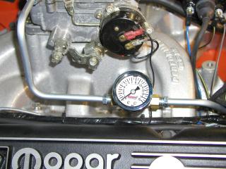

Does anyone have a photo showing where you put your fuel pressure gauge? I am thinking of putting one on my 1973 440 RR...I put one on our 1966 Malibu and if memory serves it was fairly easy to do...Marla :violent-smiley-101:

put it in-line as close to carb as possible...if your running a dbl pumper holley 4150 type , install right before first inlet to carb, if it's a single inlet,AFB,AVS,TQ or holley single pumper, install before fuel line enters carb, try to stay away from inexpensive liquid filled guages, as the fluid heats up from ambient engine temps, they may give you false reading or no reading at all.....

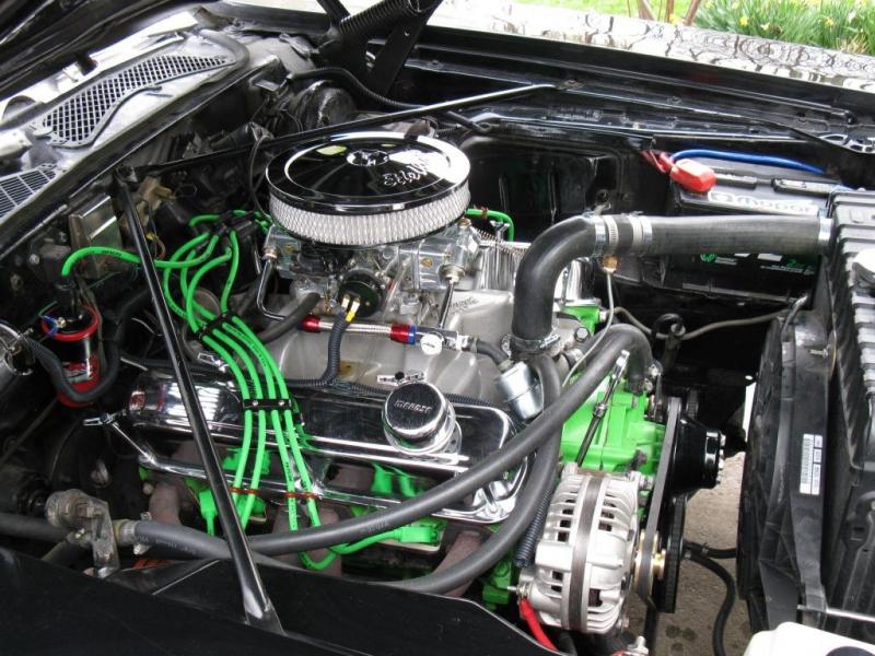

Here is a pic of mine just put it on today
