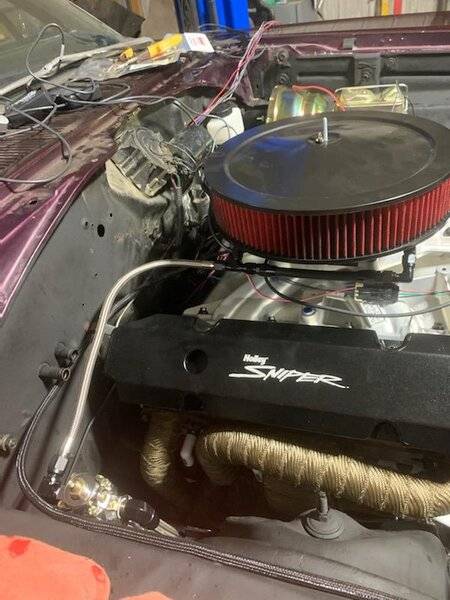

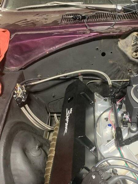

I switched to an electric pump and mounted regulator to the fender out of the way. Its the long way around for you but its an option anyway.
